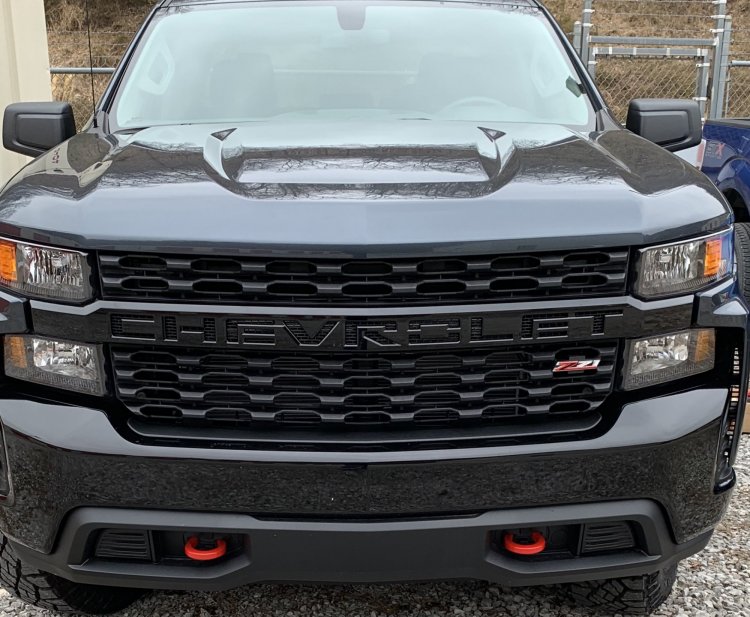

You'd have to swap all of it (bar in the middle is part of the grille assembly only for both the Custom TB and LT TB), so grille assembly and headlights.
Grille won't line up with the halogen lamps.  The LT and up lamps are narrower to allow for the cut for the grille "fins" that are around the DRL.

You probably can.
But you would have to also upgrade the headlights & turn signals, as the LED's are a different housing size than the Custom Halogens.
All of that bracketry and wiring could get expensive.

Yea. I wasn’t sure if the headlights would need to be changed.  But. I’ll be passing on the grill swap
Personally I really like the “custom” trim level grill / front end you have. Looks sharp.
I think I like the custom better too. Been looking at that bowtie too many years. Letters is a good change of pace.
