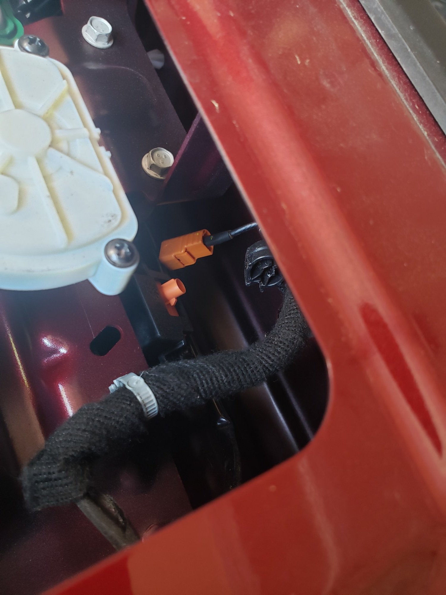

RESOLVED - I removed the inside cover panel of the bed gate to access the wiring and found the plug to the camera system had been disconnected.   Reconnected the plug and the camera system is working perfectly.   It's been about a week with no issues.
