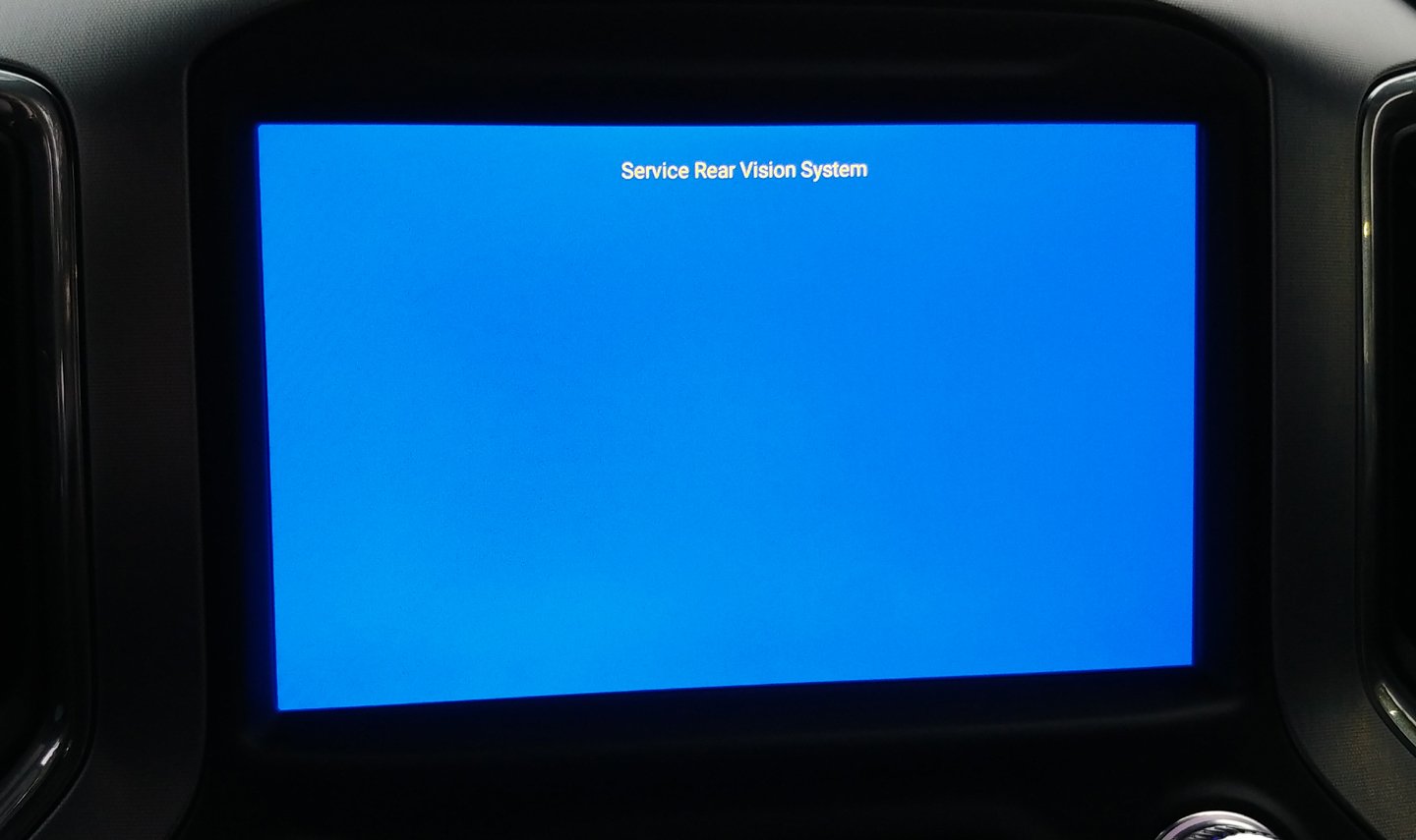

"Service Rear Vision System" on screen [POSSIBLE RESOLUTION]
Been having this issue since purchased in May.  Dealer can't figure it out.  Getting ready to file a complaint with somebody.  Very annoying.  Blue screen of death every morning and there's a bulletin about starting up and shifting too quickly into reverse without computer booting up fully.  This is not the issue.  GM needs to fix whatever crap they put in these trucks.
Yea I'm having this and a ton of other electronics issues. Not sure who you can file a complaint with, but if you figure it out let me know. In my state I don't think electronics qualify under lemon law (unlike powertrain). Seems like I'm going to wind up selling it at a loss once it winds up pissing me off enough.

Have you found a solution to your back up camera problem .... or gotten hold of someone at GM?
I've just had the 3rd software upgrade and still no joy.

I don't know if my problem is hardware or software. Most of the time the back up camera works just fine but every now and then I get the blue screen. It's usually at night and in a dark area where I really need it to function flawlessly.  Another thing that GM did that was truly dumb is that the back up lights don't provide enough light for the camera to function well. If I manually turn on my cab mounted bed light it does help considerably.  I'm going to look at how to make that happen automatically, but not until they fix the camera problem. I don't want to give GM any excuses.

I tried not shifting into gear until everything on the screen is active, including the nav but this doesn't seem to help.
I feel this problem is akin to when your home computer doesn't see a peripheral keyboard, mouse or thumb drive.

So after being without my truck for over a week, the problem of service rear vision system was cleared,  two weeks after and it’s back.  I drove a total of 400 miles and the dam thing is not working.  I’m at the point now where I am talking to the dealer to unload this thing.  I’m done,  67k Denali, 2300 miles
my dealer replaced the radio module and reprogrammed with all updates during the original repair effort,

Any notice it happening when you turn on the truck and shift into gear immediately? That seems to be the reason mine blue screens.
I've tried all sorts of combinations in an attempt to replicate the problem with a degree of reliability so that I can actually demonstrate it to the dealer.
I've taken photos of reach time it happens with a time stamp but there is no logic to when and where.
At first I thought it was happening more presently at night when the headlights were on but that's not the case.
I've tried shifting into gear as soon as I start the truck but that seems to have no effect.
It's presently happening once or twice a week.
My dealer in Riverhead NY has checked and updated software 4 times to no avail.
The last time was a week ago.
I drove out and later that same day, bingo, it happened again.
They are supposedly trying to get a tier 2 or 3 tech at GM to voice in.
