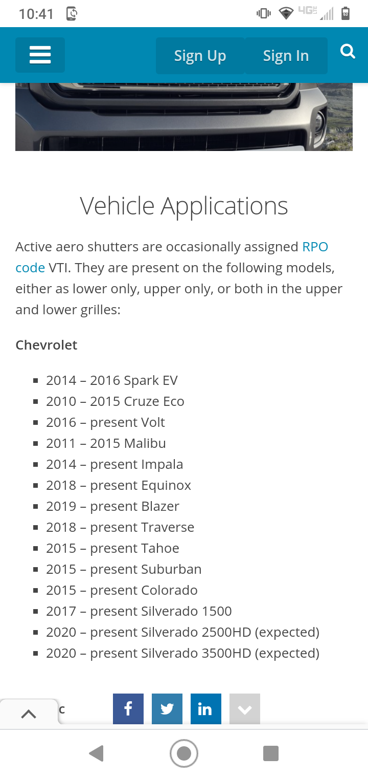

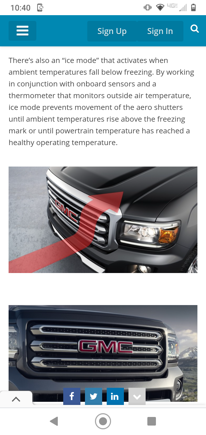

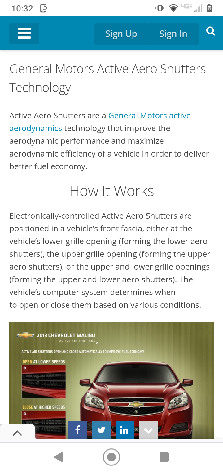

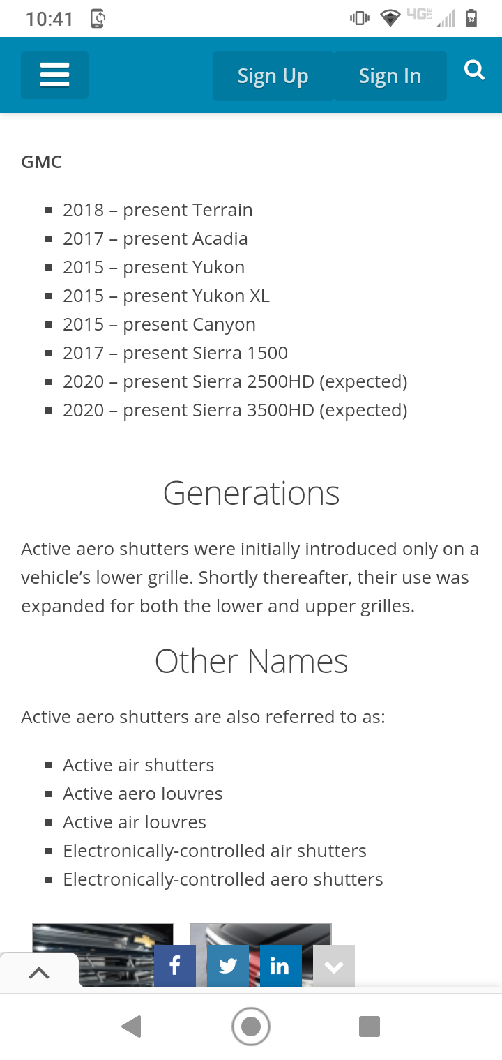

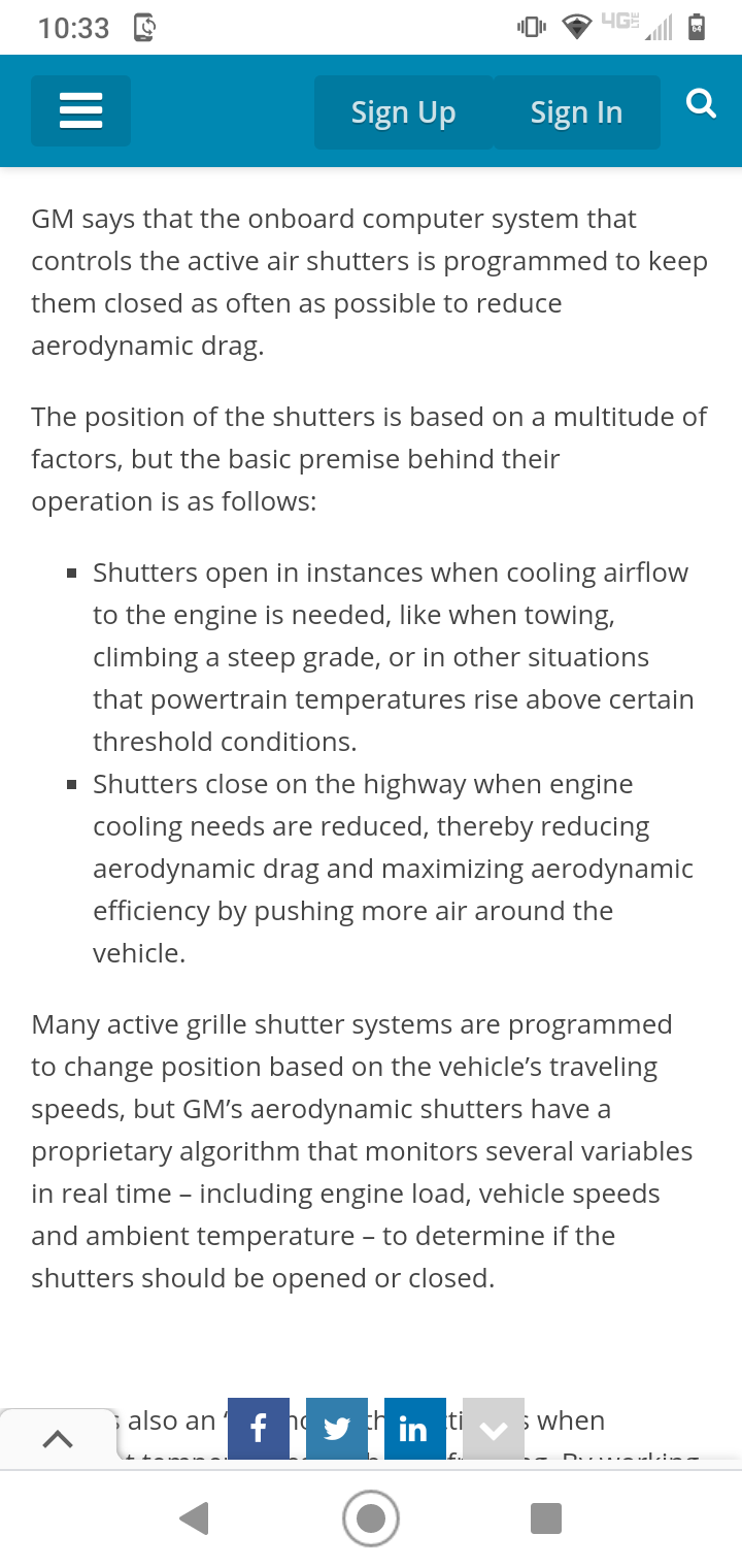

My 2019 RST 5.3L has them, I noticed by accident as I normally seen the radiator when I was cleaning it but seen the shut louvers instead! Definitely temp sensitive as they were open all summer. Saves the hassle of putting in the ol cardboard before the temp drops to -40C, lol.
