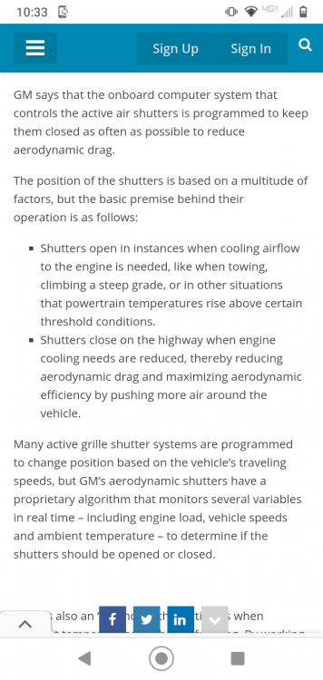

Doesn’t make sense to remove them, if there is additional cooling needed, I would think they could program them to open if certain parameters are reached. I agree with @newdude that you’re probably better off without them. Not sure on a 2019 but on the K2 they really make mounting a light bar behind the grill a PITA.

I assume you’re replying to someone else? I only said it didn’t make sense to remove them. There is obviously no way for them to break if ya don’t have them. I don’t understand why they felt compelled to remove them if additional cooing is needed....just program to open when needed??
I’m not an engineer but presumably when the engine is started cold and the t-stat is closed, is anything even flowing through the rad at that point? In other words, how would the shutters help warm it up any faster?
I would imagine they didn’t fit them because even when they are open it does restrict airflow. Probably not a huge amount but if you’re towing something heavy in the summer, maybe every little bit helps??

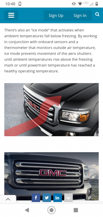

mabey at stand still no difference in warm up but driving down the road at 0 degrees has to pass less cold air over the motor with shutters closed i would think and noticed my usual spot the auto heat kicked on was extended a few mile further i noticed first night leaving work
when i remote start standing with my ear on the grill area i hear a quick click mabey someone with shutters on a 19 can look and listen and see it that is the motor closing the shutters

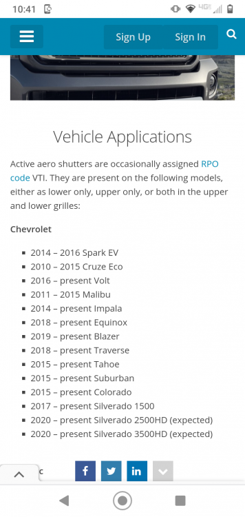

Flipped through the catalog with some VINs.
NHT with both the 5.3 and 6.2 do NOT come with active grille shutters.  The grille shutter frame is present, and that is it.  No shutters.
NHT cooling requirements eliminate the shutters and their actuation.  If you were to attempt to install, the wiring, etc. would not be present.
If you really, really, really have to have them, trade the truck?
EDIT:
Adding the shutter RPO codes.  NHT trucks won't have either show up in their build.  Also, WT/Custom/Custom TB with the old engines/6 speed don't have shutters either.
VTI - Single Shutter.  5.3 L84 and 6.2 L87.
WMI - Dual Shutter.  2.7T4 only.
Edited by newdude
ADDED SHUTTER CODES
