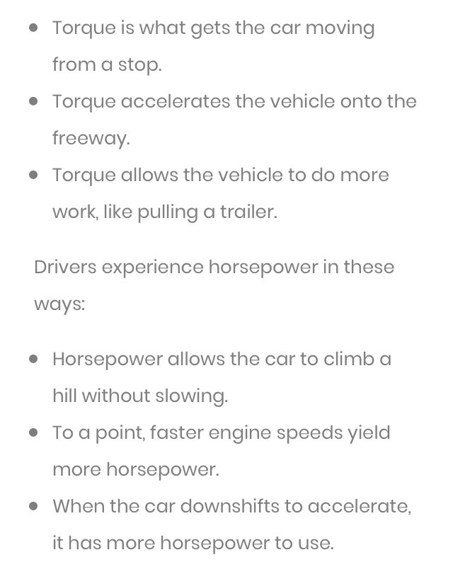

Nice of you to prove my point. Look at the TQ.
You stated holding 4K is a waste . It doesn’t reach max until 4200 . The torque is still at the level of 3500rpm when you reach max horsepower so in fact running 5k will give you more torque than 3500 rpm and a lot more horsepower which will pull better

11 hours ago, 2016HD said:
Torque moves shit and Horsepower keeps it moving.
 The truck has more capability to accelerate at 5000 rpms because it has more torque than at 3500 and will be harder to slow down because it’s near it’s peak horsepower and will have the least chance of slowing down at its max horsepower. That’s why you punch the bitch to keep speed
