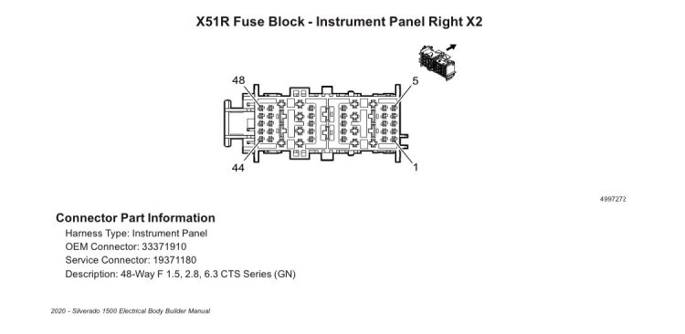

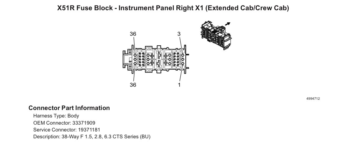

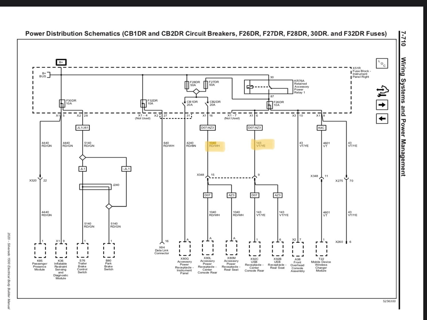

On 7/17/2020 at 6:36 PM, trip said:
So figure out the wire diagram for wiring harness for the USB and 12v outlet straight to the fuse box it belongs to. Right fuse box on X1 plug you will add a terminal pin to 6 and 16 you can order a five wire kit for these parts 19332365 and 19332366. For the ground on the back side of right fuse box is x2 with the correct ground you can either re-pin that connector or just tap in to that wire it’s port 1if you decide to re-pin it here is a wire kit to help 19371175
Does this make USB function as OEM? Does the radio recognize it for CarPlay?
