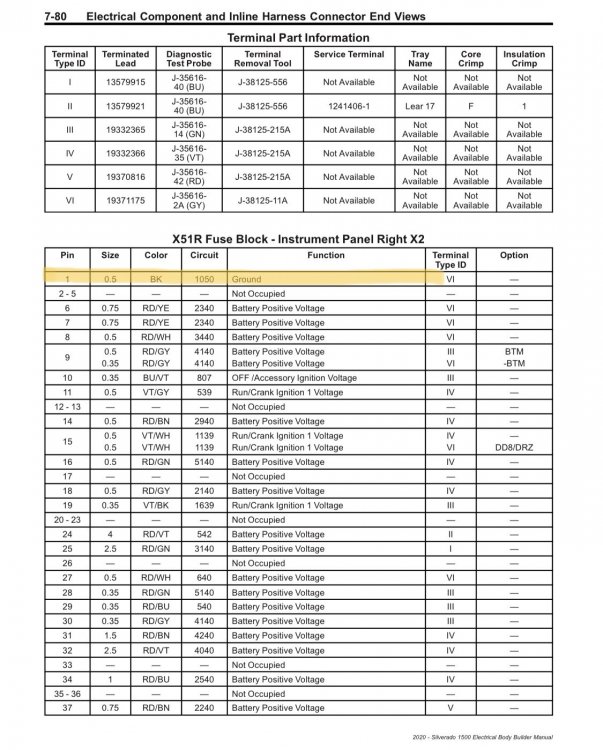

I did get the center seat / console installed last week.  I was going to try using an offset wrench on the rear bolts to avoid removing the seats, but I ended up just unbolting both seats (T50 socket) to have proper access to the center seat bolts.  It was easy with the driver and passenger seats slid to the side.  I made sure to put new blue thread locker on the seat bolts, and torqued them to the values that my factory service manual said for my old 2000 Silverado.
I used the https://www.gmupfitter.com/ website to find wiring diagrams to what I was dealing with.  As I expected, the wiring assembly to the floor under the passenger's seat was not present.  But, I did ohm out the two big pins on the jump seat's connector to the accessory outlet and figured out which is +12v and which is ground.  I didn't have enough time to make up a cable, but it should be simple enough to run wires from the passenger side fuse box, through the trough, and under the passenger's seat to connect to the cable.  It'll be a little ghetto with just two connectors attaching to the giant connector, but it should work.  It appears that there is a converter box in there to power the USB ports from the same +12V and ground, so I may be good to go.  I just need to find some time to work on it again....
