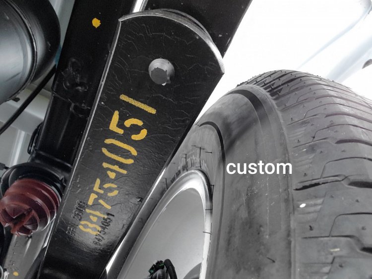

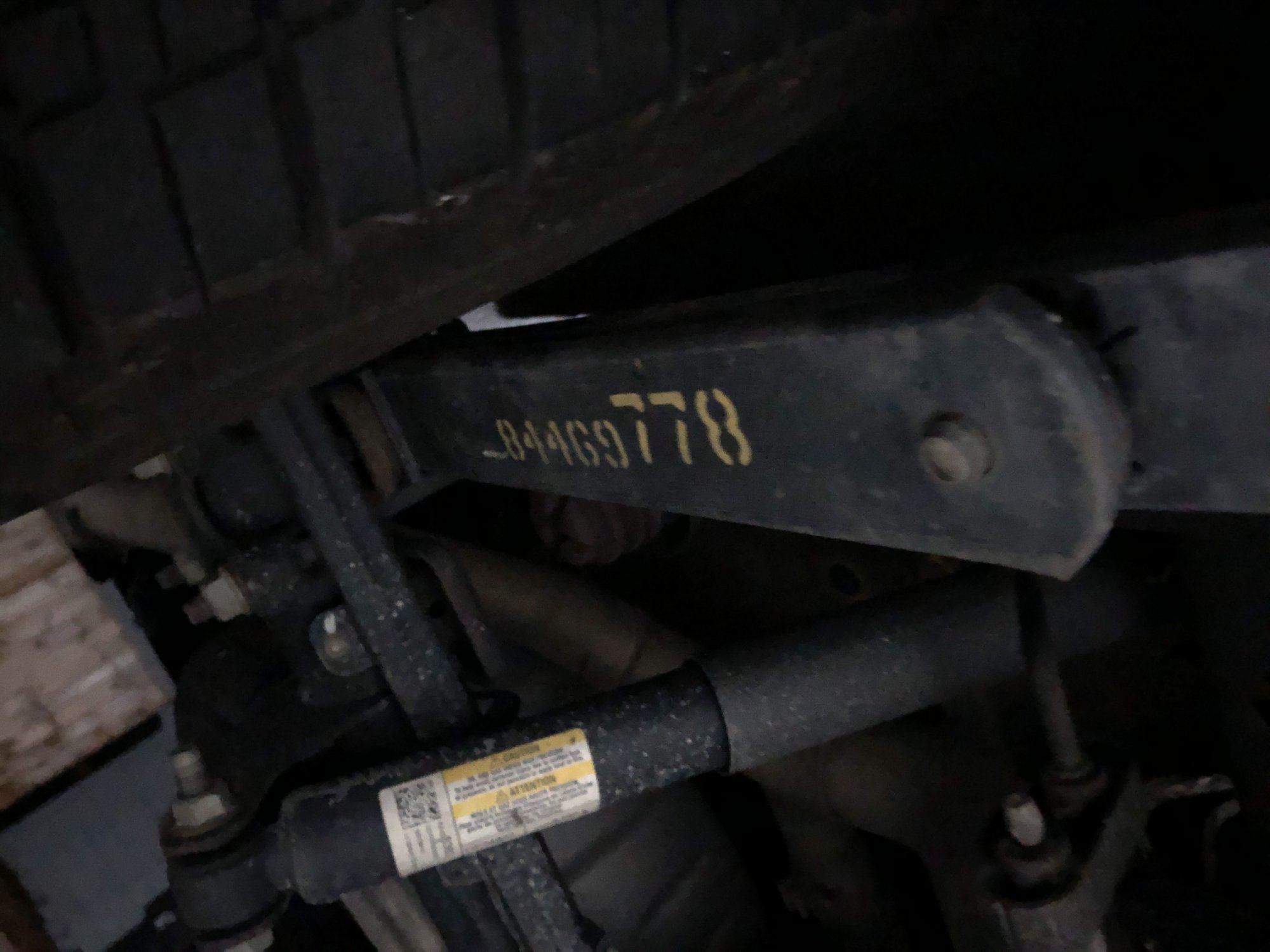

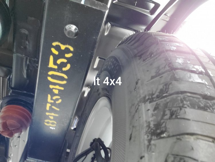

Boils down to a matter whether to believe either one of them or my lying eyes. To early to check replacement numbers, so next time at the dealer, it's flat on my back pulling numbers off the springs of a '20 RST for comparison against mine. Other models too.
Checked the '19s, all US Vin "1"s on the lot  all LT, RST and LTZs had the same suspensions with the same rear leaf springs  84469 777 all the Z71 Rancho shock variants had 84469 779...  A little weirded out, all said "Made in Mexico" instead of "Hecho en Mexico", winder how the "3" VINs are labeled? Only on 20 in stock, a loaded LTZ in the showroom quick looked like had the same numbered  777 spring but wasn't about to creep out customers by getting underneath with a camera to take a good look and photo......I'll wait until they get a new shipment stored on the lot.
Three different so far for '19s:  base ver. LT, RST = 777   Z71 opt.= 779   TB opt. = 780.  I'm guessing the higher the number suffix, the more HD the spring for off road use suspensions
Anyone got the 778?   Customs?
