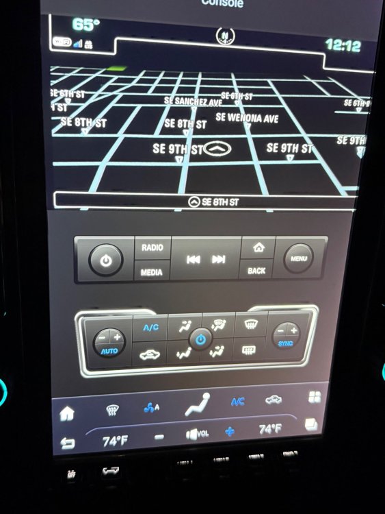

Here's a few pics of my setup.
How did you get this on the screen? I just installed one of these in my truck and I like that launcher. Also do you use waze? If so have you been having trouble with it at all on ur unit?
Lectrician7, that's the Agama car launcher. It's on the Google Play store. https://play.google.com/store/apps/details?id=altergames.carlauncher  The logo in the middle can be several things from a compass to a clock and even an info center for other apps. I had to change the theme and colors a little to make it look like that but it was real easy. To be 100% clear, neither this launcher or any other launcher I've tried on my device works correctly.
I've never used Waze. I can tell you that the Google maps that ships with the device works fine. The problems start when you upgrade the old Maps and the new Maps will not scale correctly. It works but the upper green bar is way bigger than it should be. I use the default Here nav app and it so far it works great.

Thanks for letting me know what launcher that was.What version is the google maps are you running? Mine came updated to a version that has the HUGE green bar. If yours doesn't have the green bar I'll install it and not let it auto update. The issues I had with Waze was no audio commands ( I fixed this somehow) and now the audio player won't connect to TuneIn Radio, iHeartRadio, and Pandora, but I thin k it's an issue Waze needs to correct in an update.
I think (but I'm not sure) it came marked as a Phoenix product. It is a fast boot version with 7.1 on it. I did do the update for it that phoenix had posted in their drop box account. They have a video on their YouTube channel that explains it and posts a link to the file. I've heard that some launchers cause them to slow waaayyy down, so maybe that's the issue? Mine came with the original screen portion way to the right but the touch wasn't offset with it. I had to adjust the parameters on mine and 7 works perfectly. I believe my truck came with I06. It had the 8" screen that has Bluetooth and factory NAV since it's a loaded SLT.
The only other issue I have is, in order for it to connect to WiFi I need to go to the WiFi settings page then it connects to my phones hotspot, but it won't automatically connect until I do that. These radios are clearly not a simply plug it in and go kinda thing, they require some setup and work.
Lectrician, sounds like you already have the upgraded Maps. The version mine comes with still has the robotic voice but works well. When I update it to get the modern voice, then I get the green bar. Other than the green bar taking up a bunch of space and the search bar being a few inches too low Maps technically works. I've had occasional issues with voice guidance on Here and Maps. I think it comes down to the audio focus of the unit. I'll give Wazes a shot and report back what happens. I've heard good things about it from others but never tried it cause I was a big fan of Scout and had Maps as a fallback.
