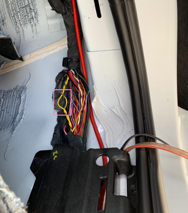

Any tips on how you connected the LC2i with your Bose stereo baldor18? I have 2019 AT4 with Bose and a sub and amp out of my old gmc and want to get installed.
Yes, under the passenger side, under the carpet theres a thick harness open those up and i used the yellow black as a negative and the solid yellow as a + and made a little speaker cable Y to hook it up to both speaker inputs on the LC2i and it works great. the other option is the other twisted pair of cables on that same harness is for the back speaker you can use that one as  your second set
Somewhat off topic, but sounds like this group could help.  Started installing a small sub/amp combo.  Tapped in to that twist pair yellow and yellow/black in the passenger side kick panel area.
After install all I have nearly zero sound from the rear door speakers (factory Bose set up). Extremely quiet, almost nothing but highs.  If I fade it to the rear only, there’s almost no sound at all from the system.  Fronts still sound great with no change in sound.
Thoughts?
Edited by Jackwards
Thoughts?
What are you installing? Did you throw a signal processor inline? Like the post above he put in an LC2i, which you would at least need to accommodate the sub/amp.
