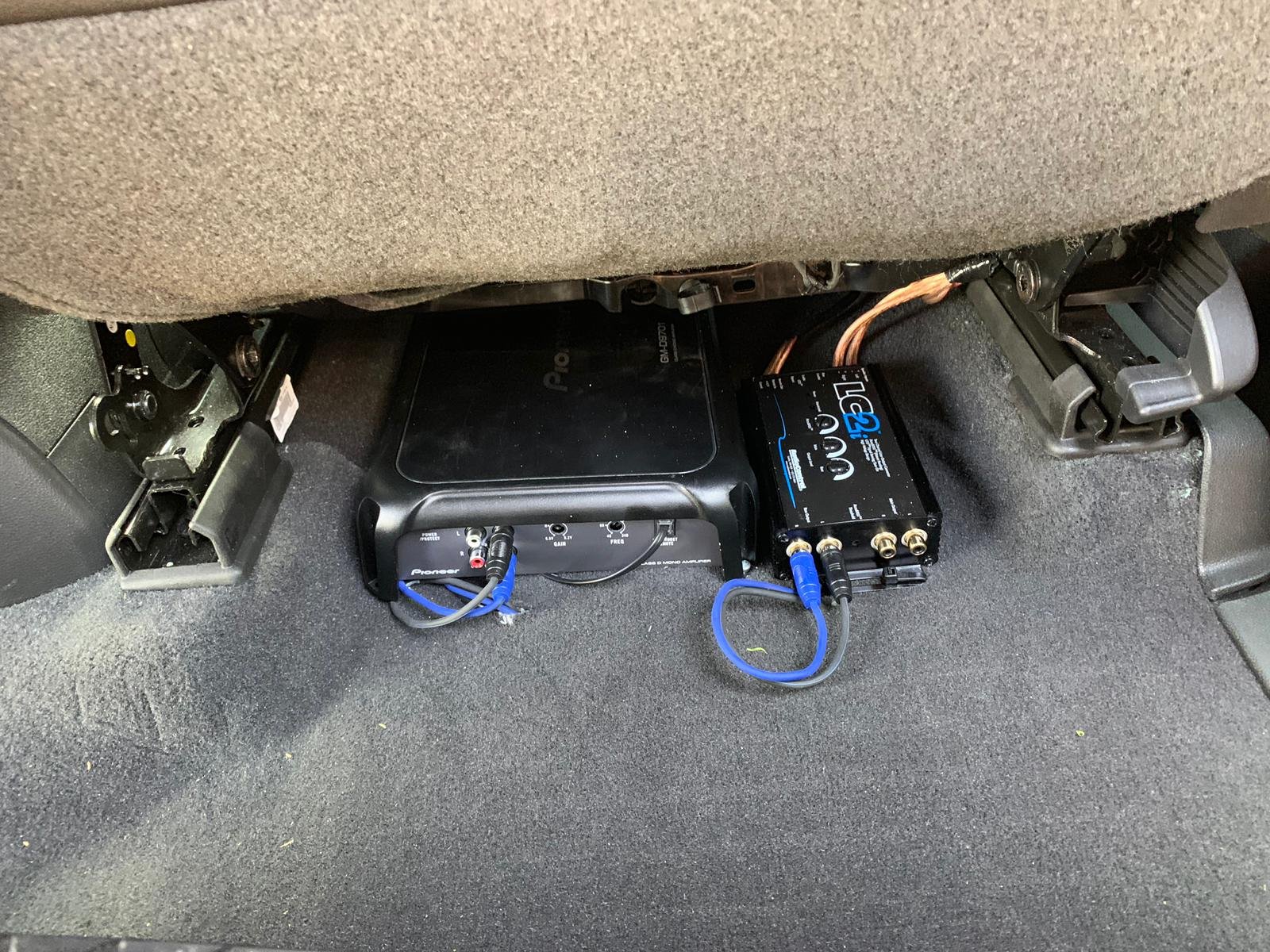

I just finished my install in my AT4 with Bose system, I spent $390 and it’s sound ridiculously good. I put in a pioneer mono amp D9701 a pioneer 12” SWX3002 that is already boxed and fits nicely under the seat and an audio control LC2i. Install was easy the truck has plenty of space for running all the cables. Has enough space for the amp and the line converter under the passenger seat. I had the Kicker OEM on my previous truck and it did not have enough kick for me.
I tied uploading pics but it only allows me 4.8mb
