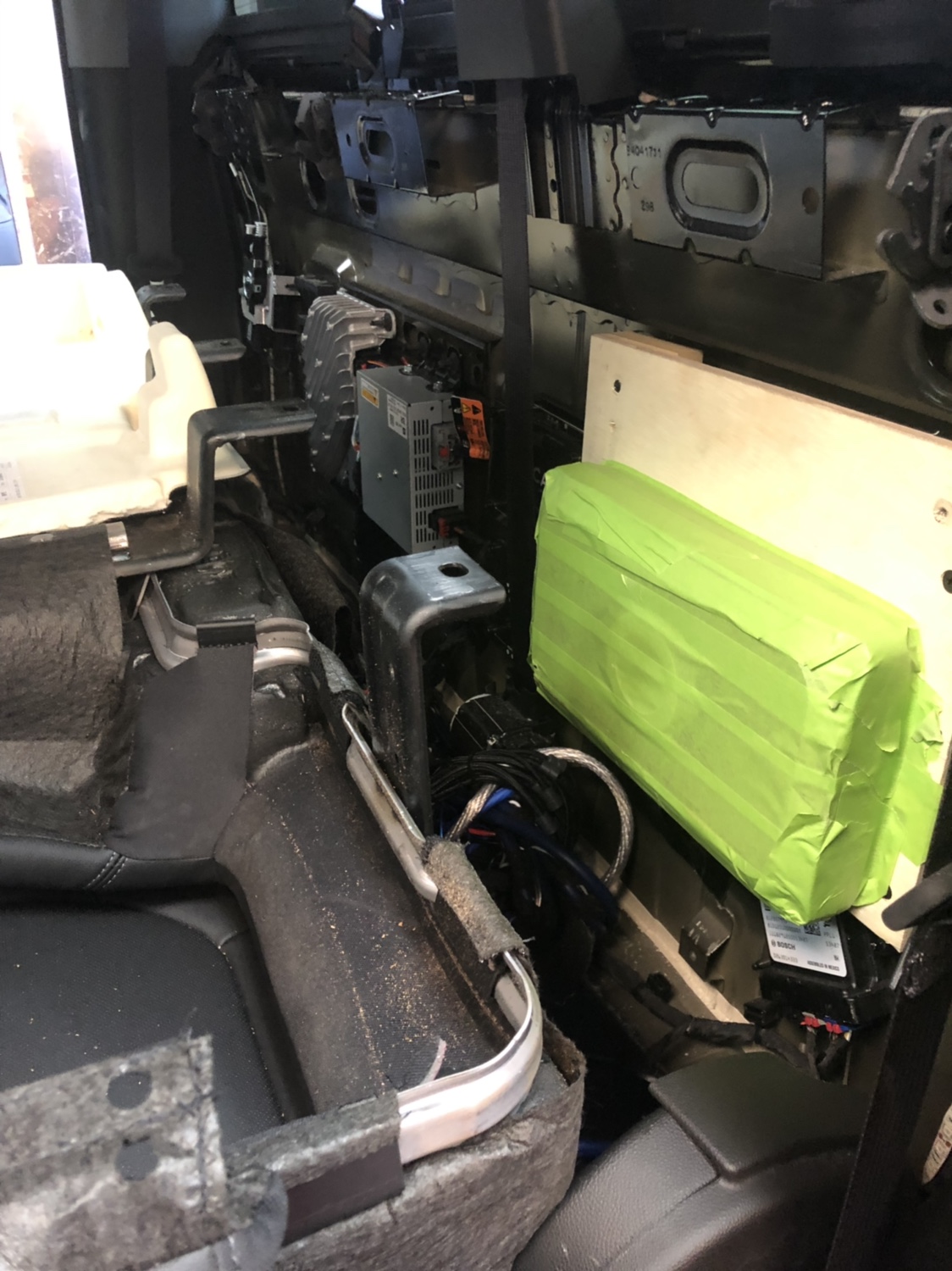

I just installed Focal ES 165K3 and replaced the Bose system. I had a custom ported box built for 2 JL Audio 10TW3. JL HD1200 amp installed into the cubbie hole of the rear seat. It looks and sounds better than anything I’ve seen in a truck.

I did not have any issues. I did have to purchase a DSP (digital signal processor) due to having a timing alignment issue cause of the Bose system.

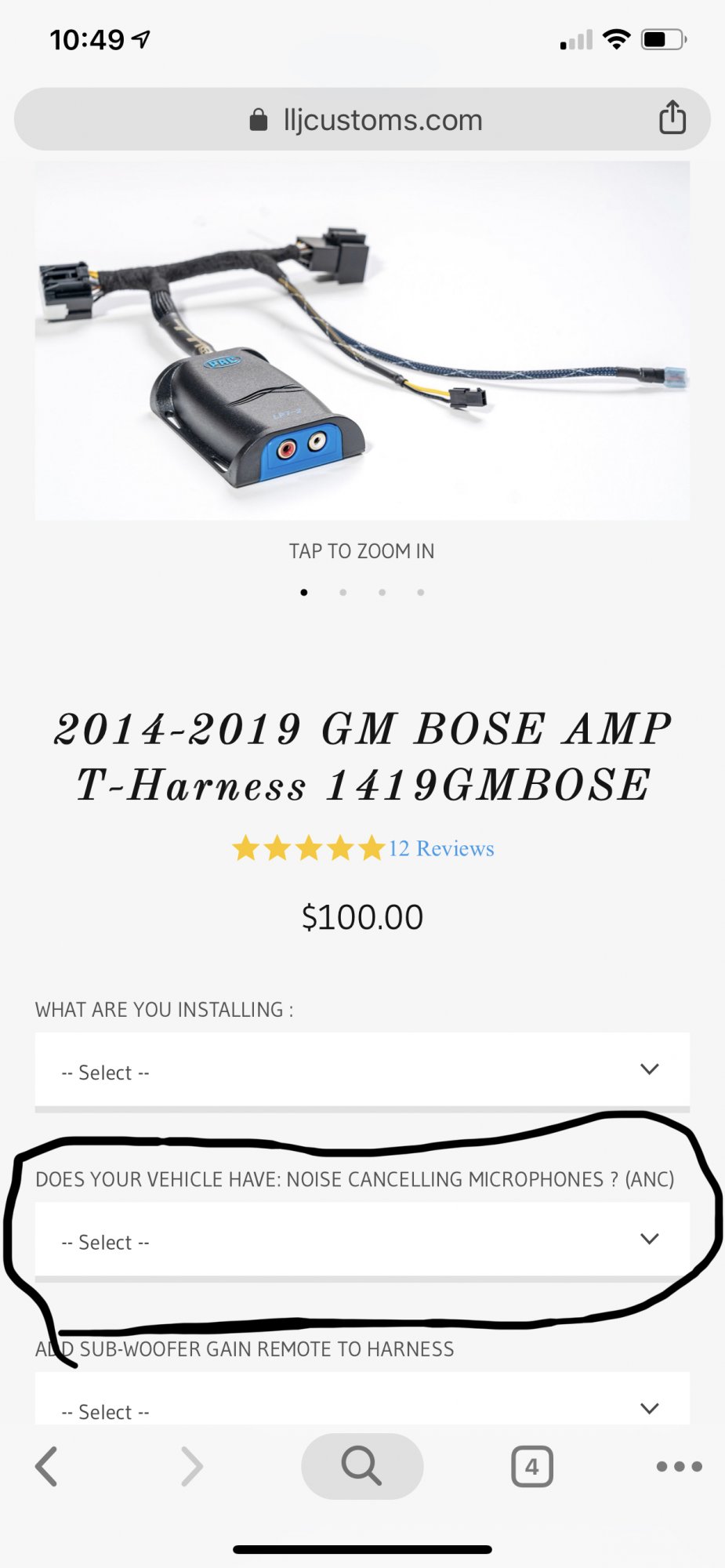

So I just ordered the T-harness from LLJ Customs for my AT4 with Bose, and I meant to go back and see if we had noise cancelling like I circled in the pic and accidentally left it on no.  I think we have noise cancelling not sure, and does anyone know what will this affect.  Not work at all, work the same etc...  Thanks for any info. 4F4C76F9-83AE-4762-BDB5-EA8CEAD2A2DB.thumb.jpeg.7b213249d8fcc74f048e1fd03a74042d.jpeg
