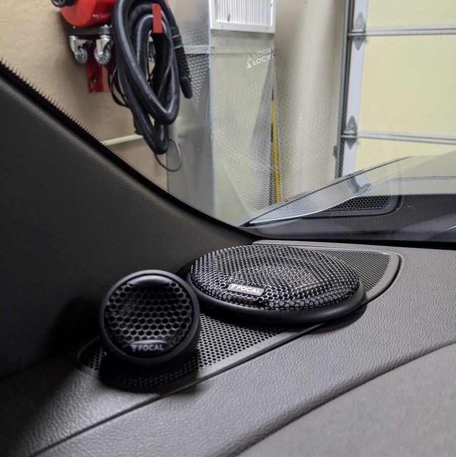

Hello,
I would like to upgrade my amplifier so I can sum up my channels and adjust speaker levels.  I have a 2019 GMC Sierra with the Bose system I recently upgraded my speakers to Focal Access series, here's what I have Focal Performance 165AS3 and Focal Performance 690AC. This made an enormous difference in sound quality, I placed the mids and tweeters up in the dash I couldn't hide them but that's ok I took the woofers and put them in the rear doors and the 6x9s in the front doors and when I sum up, I'll add tweeters to the rear doors, and I'm not concerned with adding a sub right now I just want six channel control. I have read must of this thread and it's obvious there's diverse opinion on which is the best way to go. I keep going back to LLJ Customs Car Audio Fabrication loop harness with an AudioControl D-6.1200 this harness connects to the tuner before the Bose amp.  So, I would like to get people's opinion on that setup and more importantly the cons of going with it. Thank you.

Hello,
