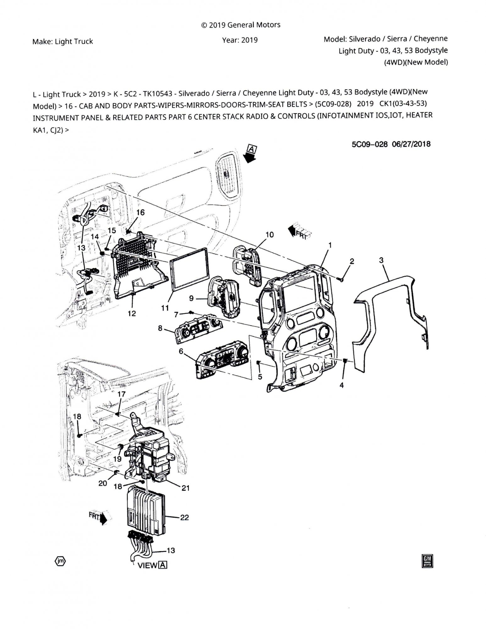

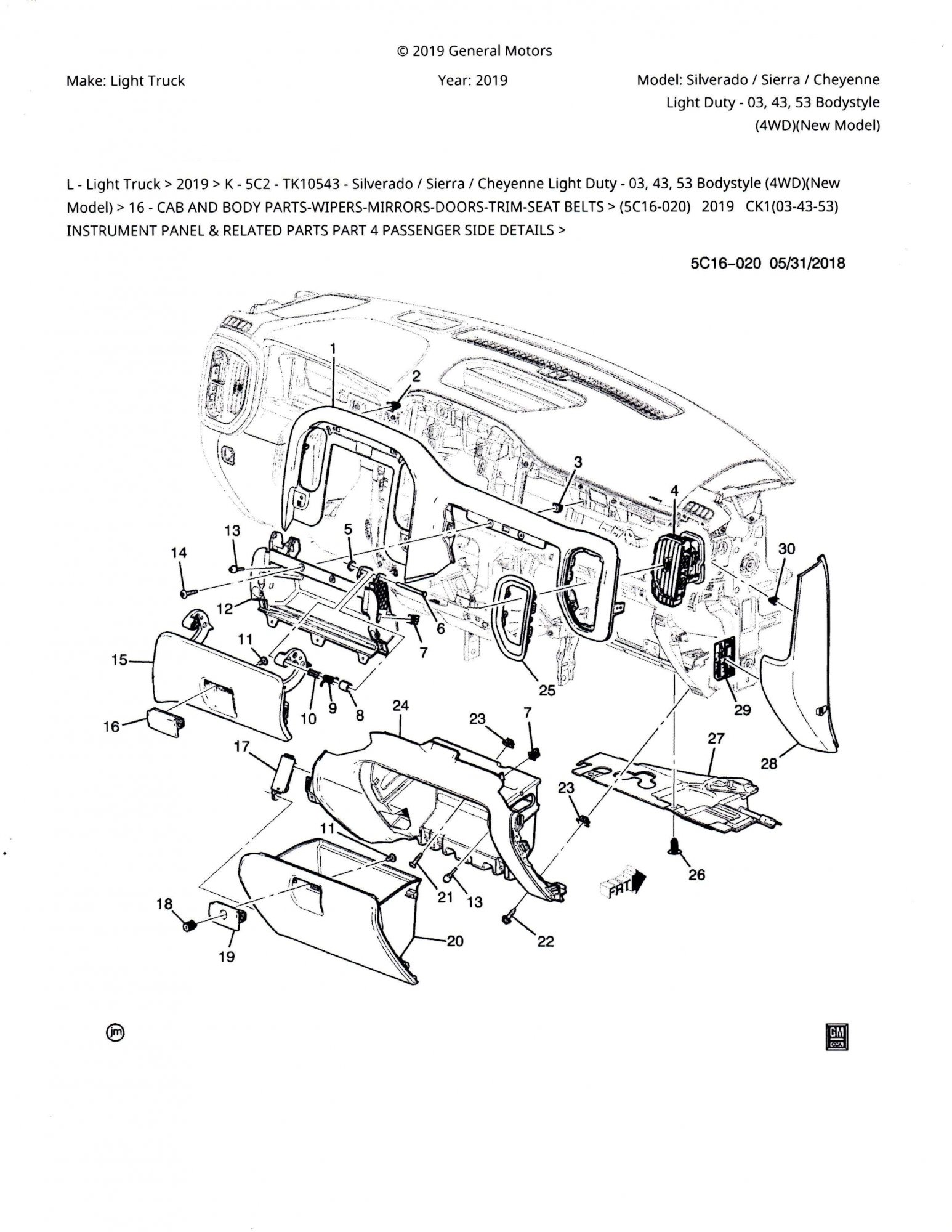

Now I just need the exploded diagrams for the speaker locations in the doors, dash, and for the subwoofer. Do you know if the dealer will let customers buy the service manual with the diagrams for the new models yet? I'm guessing it will be a while before the Haynes manuals come out.

I just asked for those at the dealer and they printed them out for me.  When you tear yours apart will you make a video I can follow. I’m having a hard time with mine.

Any chance you could show us how you got behind the dash to wire it into the factory stereo?  Does your truck have the center console?

Well crud. That’s the part I can’t figure out. Any chance you could ask the them how they got behind the dash?  Where all the screws are (and how many) to remove the black trim piece that encompasses the climate controls etc.

Do you have bose? If you happen to get it out, can you take pictures? Nav TV doesn't have anything for 19's yet. I'm guessing they need pictures of the back of the headunit where everything connects to make up a system to get a clean output.
