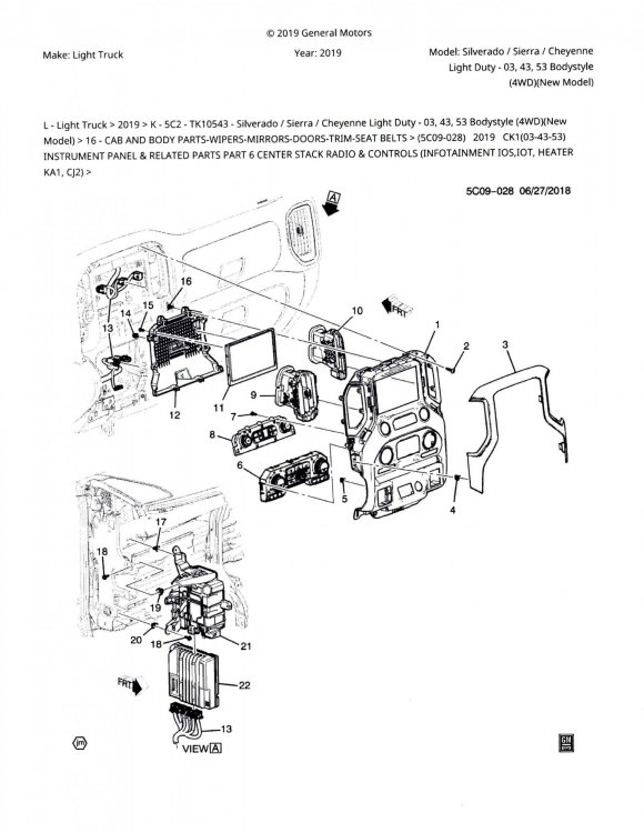

Has anybody taken apart the dash to get behind the nav screen?  How did you do it in the new 2019?  I can easily get the bezel trim off, but after taking off the four screws around the main big plastic piece that encompasses the nav screen and climate controls, I have a hard time figuring out how to pull that big piece out.  Any help would be greatly appreciated.

I tried twice, and couldn’t bring myself to pull any harder, actually the hardest part is finding a reasonable place to start pulling.
If anybody has access to the exploded schematic that would be excellent! Just to make sure there isn’t a hidden bolt somewhere

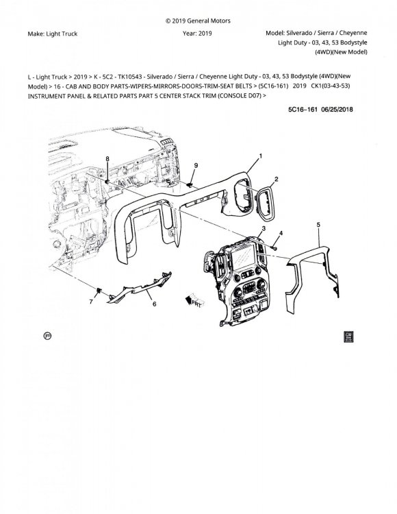

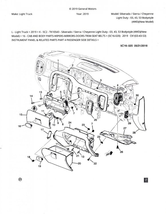

Got the schematic from my dealer -- not sure how much it will help me honestly -- I can't figure out where there might be a missing screw or bolt - here are the pictures in the following posts
