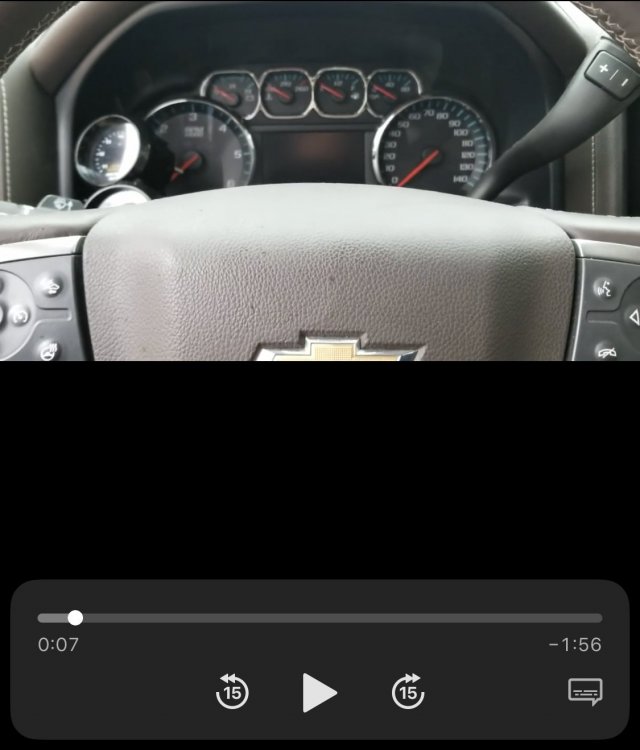

Proper scan?  You mean like BCM and ECM scan?  My ECM isn't doing much of anything because nothing can connect to it.
I just ordered a new starter, positive battery cable, and negative battery cable. Amazon will have it to me by Wednesday. I'll throw it all on and see what happens. If still no start, I'll put it on my trailer and tow it to the dealer for a scan and see if they have an issue connecting to the ECM too. As of now, I'm leaning towards a failed ECM.
You have to know which modules are communicating and which are not. Then check power and ground at them. Then if they have power and ground you next check the networks. It's a process and can be fairly quick or  take a long time. Clearly, if the PCM does not have power or ground, you don't need to check the onstar module. One tip, check between the battery and right front fender for rodent damage. It's a common place for them to chew wiring. One more thing, any module on the high speed circuit can take the whole circuit down. The Onstar module is a common module to do just that. You can't just unplug a module to test. You have to jump the network circuits.

It is possible for the starter to cause electrical problems, but I think it would probably have to short out internally, combined with a simultaneous solenoid failure resulting in a "stuck on" position. This would kill you battery pretty quickly. If you want eliminate the starter as a possible cause, you could disconnect the wires from the starter, and turn the ignition on. If everything works perfectly on the dash, reconnect the starter and check the dash again. You can also bench test the starter by using a car battery and jumper cables. Or you can test the stater in the vehicle by crossing the terminals with a screw driver.

For those interested, my ECM failed. Replaced it at the dealer today and had it reprogrammed. Back in business!
