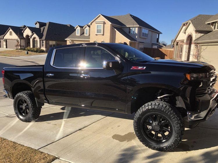

I just did mine with a pro comp 6inch lift. My wheel setup is 22x12 -44 offset and tire size 35/12.50R22 minor trimming done
Are you rubbing anywhere after the minor trimming on the x12’s? Do you know roughly where they trimmed? I’m assuming both front bumper and mad flap?

I only rub when I turn a full left and that’s slightly the mud flap was kept. They did trim the inner side of the mud flap a bit because tire would rub but there was no bumper trimming.

Thanks Dan! Nice to know they only had to trim the mud flap. I'm hopefully going to order wheels soon once I make up my mind on style and size haha. Was going to do 20x10 but now considering 22x10 or 22x12. I like the tires to stick out past the fender but not sure if I want the x10 or x12. I had the pocket style fender flares on my tundra and really liked it and my tires stuck out about an inch or two past the fender flare. and I feel like if I ever did that on the Silverado then I'd definitely want x12's. I have yet to see a new Silverado with fender flares to see what it looks like though. decisions decisions.

Not sure if you can tell but its very minor trimming the mud flap did get trimmed though. You can also notice a bit of rubbing but it’s only when I do a full left.
