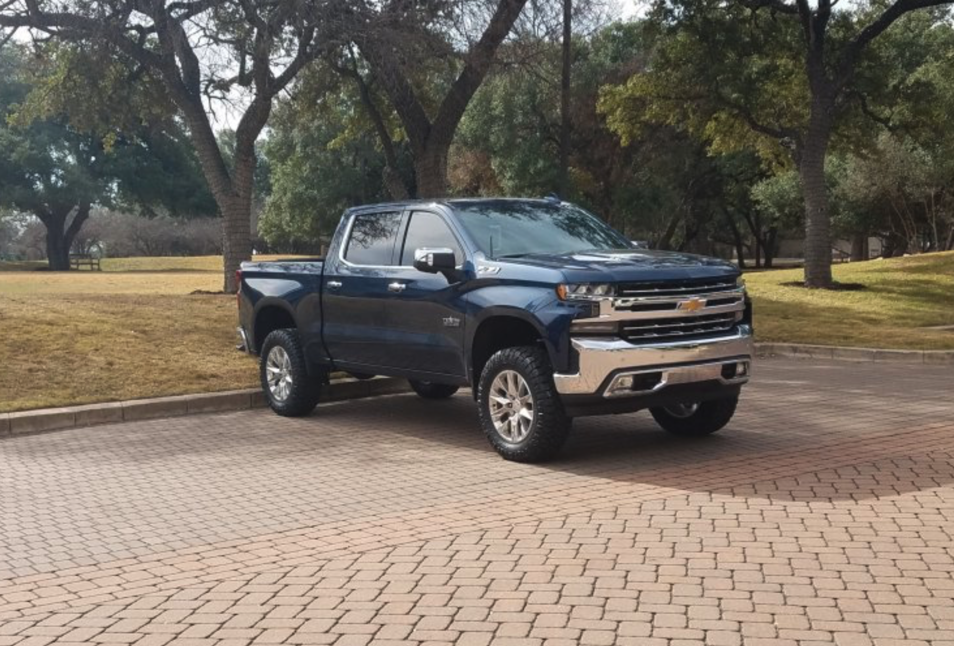

FWIW my post was in reference to this truck not the other one lol but hey to each his own:
64717620_ScreenShot2020-03-08at6_22_21PM.thumb.png.a947ec6ef911630745d46a52d964c940.png
The 4" lift, stuffed 35's, and factory rims is the cleanest I have seen any of these trucks. Too much wheelwell and ride quality/performance loss with these other lifts IMO. But again, to each his own. Just hadn't seen anyone with a 4" lift on here until the past week or two...
