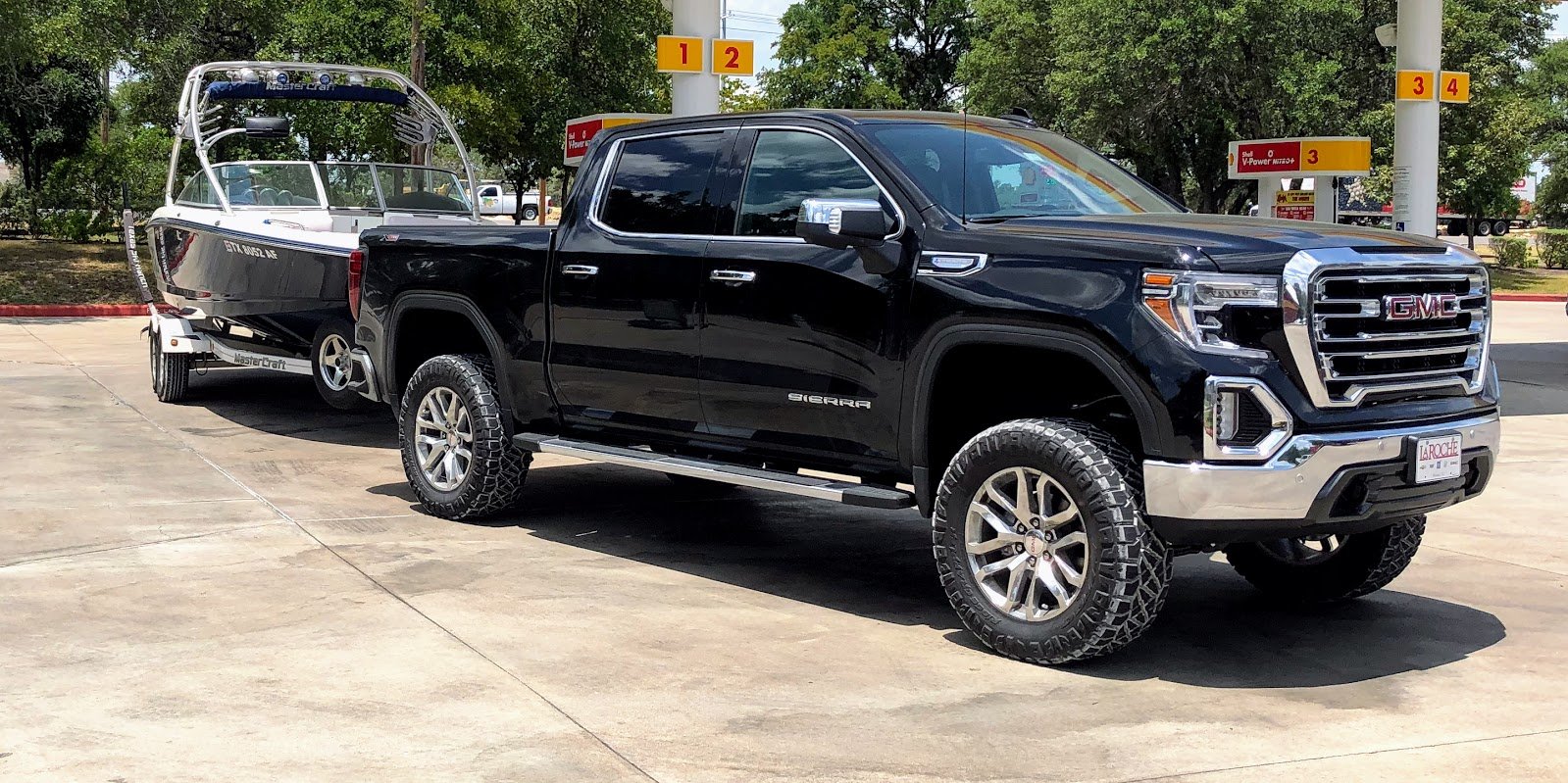

6" procomp lift.  35x12.50 Toyo R/T tires ---- Fuel 20 x 10 wheels ---  FYI The shop that did mine found out that with these wheels they had to install flush mount Tire Pressure sensors..   the regular stem ones  broke off the first install.
I'm very happy with the ride quality.

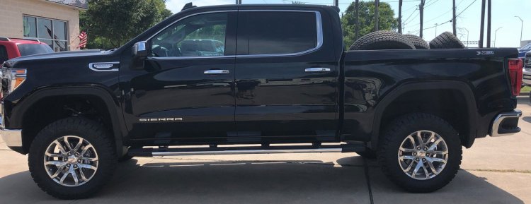

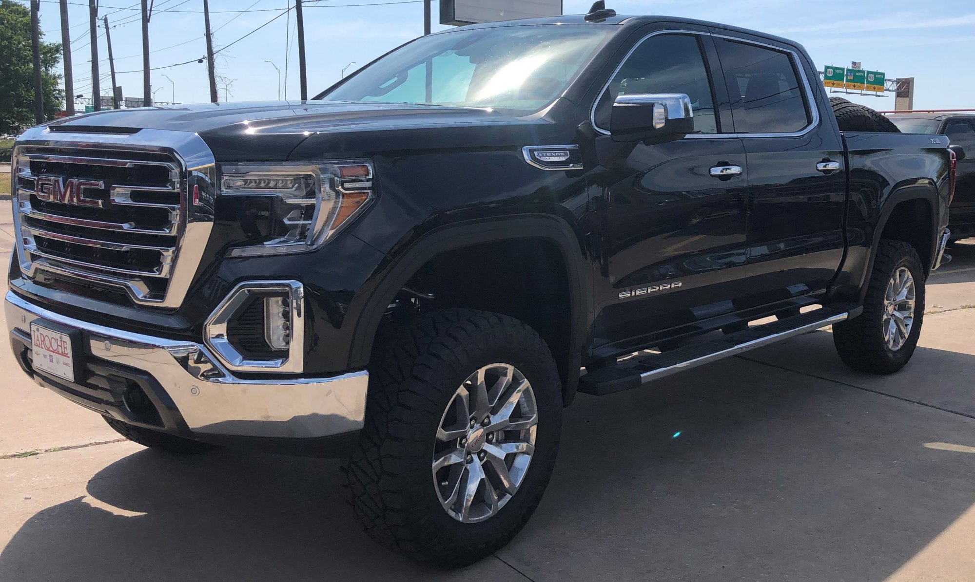

6in BDS with fox 2.0 rear on 35x12.50 Nitto RGs factory 20s
Rides good but the Rancho struts have this weird vibration after a small bump. My guess is the ranchos are not made for the heavier 12 ply tires.  Need some coilovers.  Anyone switched to Bilsteins in the mean time?
