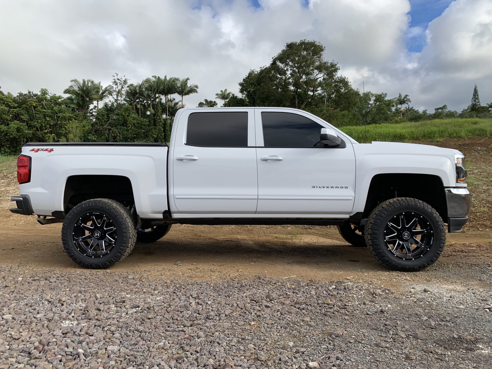

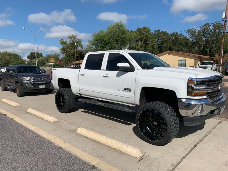

I just finished lifting my 2018 eAssisted Silverado. I went with an 8 inch Superlift, 24 MotoMetal with -76 offset, Amp Terrain Attack 35x13.50's, and Bilstein Shocks front and back. The installation went smoothly, no issues at all, the ride is better than stock.

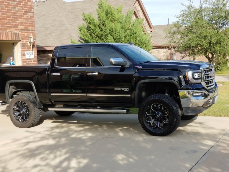

Older thread but still throwing in my experience. I put a 6" Fabtech suspension lift with 20x10 Fuels and 35" K02s on my 2018 GMC Sierra 1500 SLT w/ eAssist. I also installed a Volant cold air intake, and a custom exhaust. The main thing that caused problems was the intake because of the location of the coolant reservoir not normally in that spot but there because of the hybrid battery. Just had to get creative with moving it out of the way a couple inches. There was rubbing from the wheels but that stopped after I removed the stock fender flares and installed some Rough Country flares. With all the work done, I then added a Range AFM Disabler to run on 8 cylinders at all times. In hindsight, I would not have gotten the eAssist but that's all the dealer had coming on the truck at the time and it's worked out okay.
