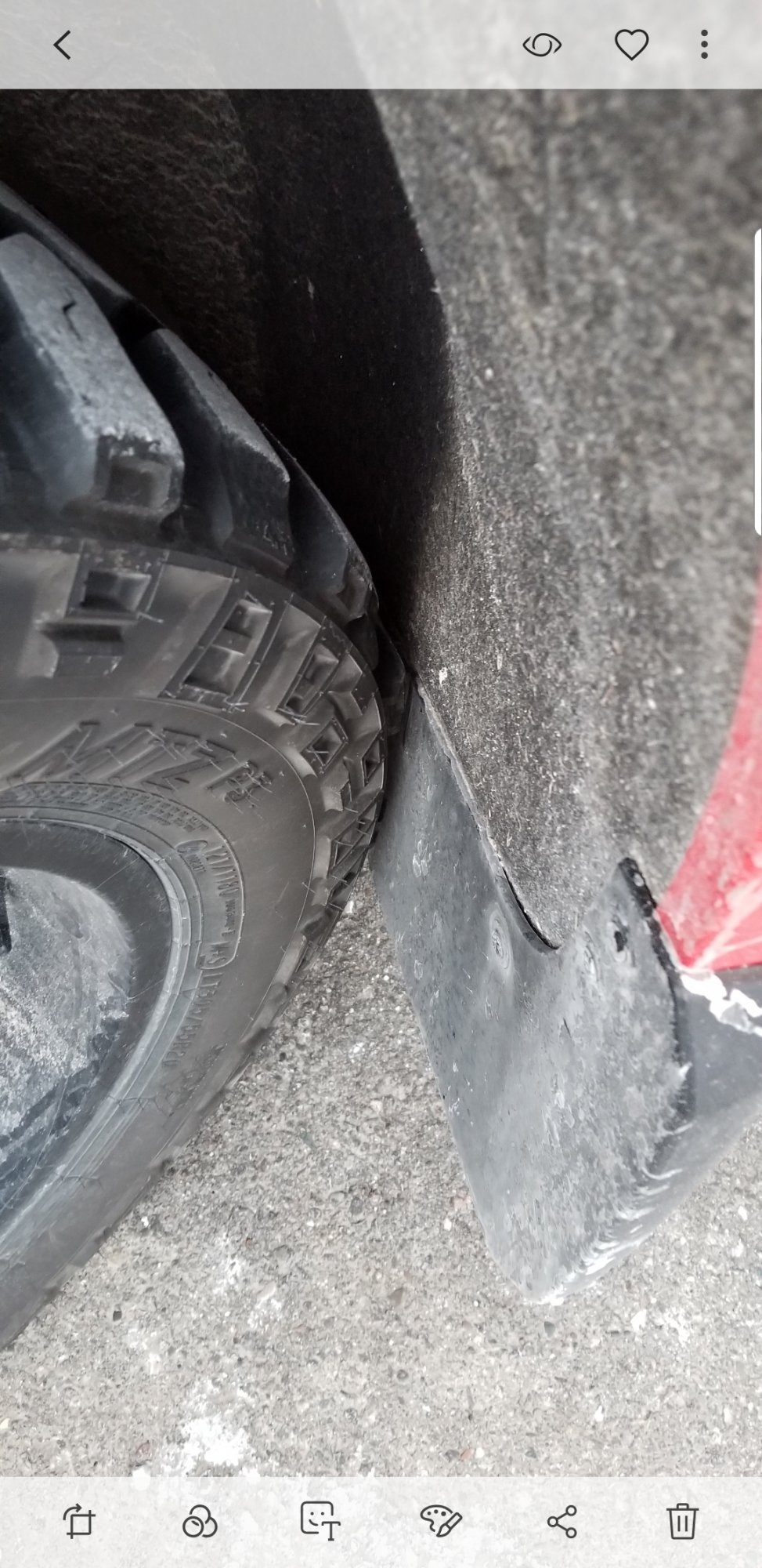

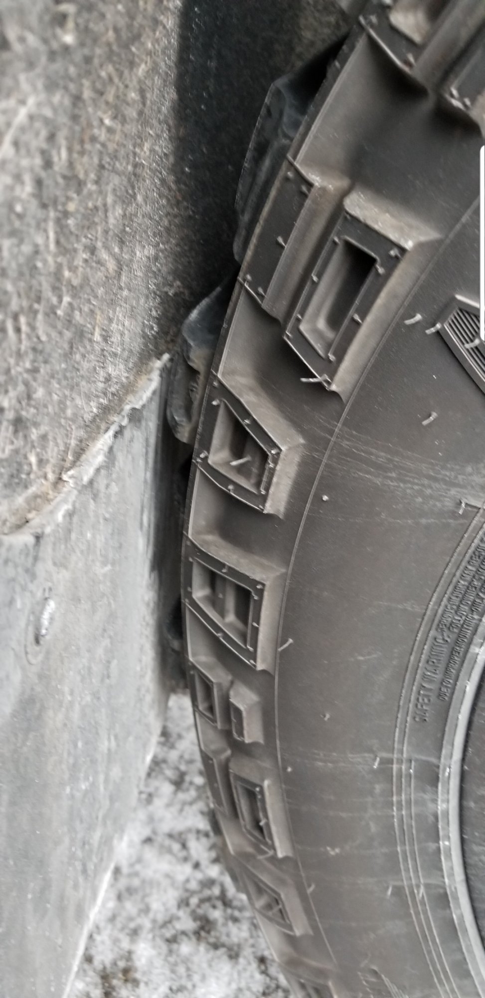

Let me check tomorrow morning.  I believe you will be fine but I'm gonna lock my wheels from side to side and see exactly how and where it rubs.

So based on what I saw this morning, I believe it may ever so slightly rub.  Even though you are removing some of the width, you are adding about .2 inches on each side of the tire which will close the gap you are gaining.  Honestly though I dont think you will notice it unless you do a lot of full lock turns.  It's your call if you want absolutely no rub at all or dont mind the slightest rub sometimes.  Let me what you do and how it works out and also if you have any other questions.
