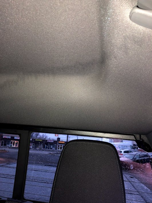

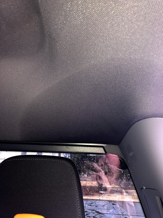

Well three months dry after the first two repair attempts. Wash the truck tonight and it's BACK! Looks like it's back to the dealer again tomorrow. Hopefully for a window replacement this time. I don't think there is anything left for them to possibly caulk.c114c74f65b80d444579c16a5f2b859a.jpg
