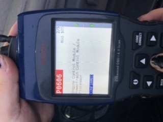

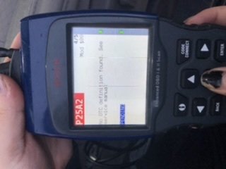

when errors are on display brake pedal not Working. So it affects the brakes. I will check power steering. Went to Oreilys. Threw five codes.
