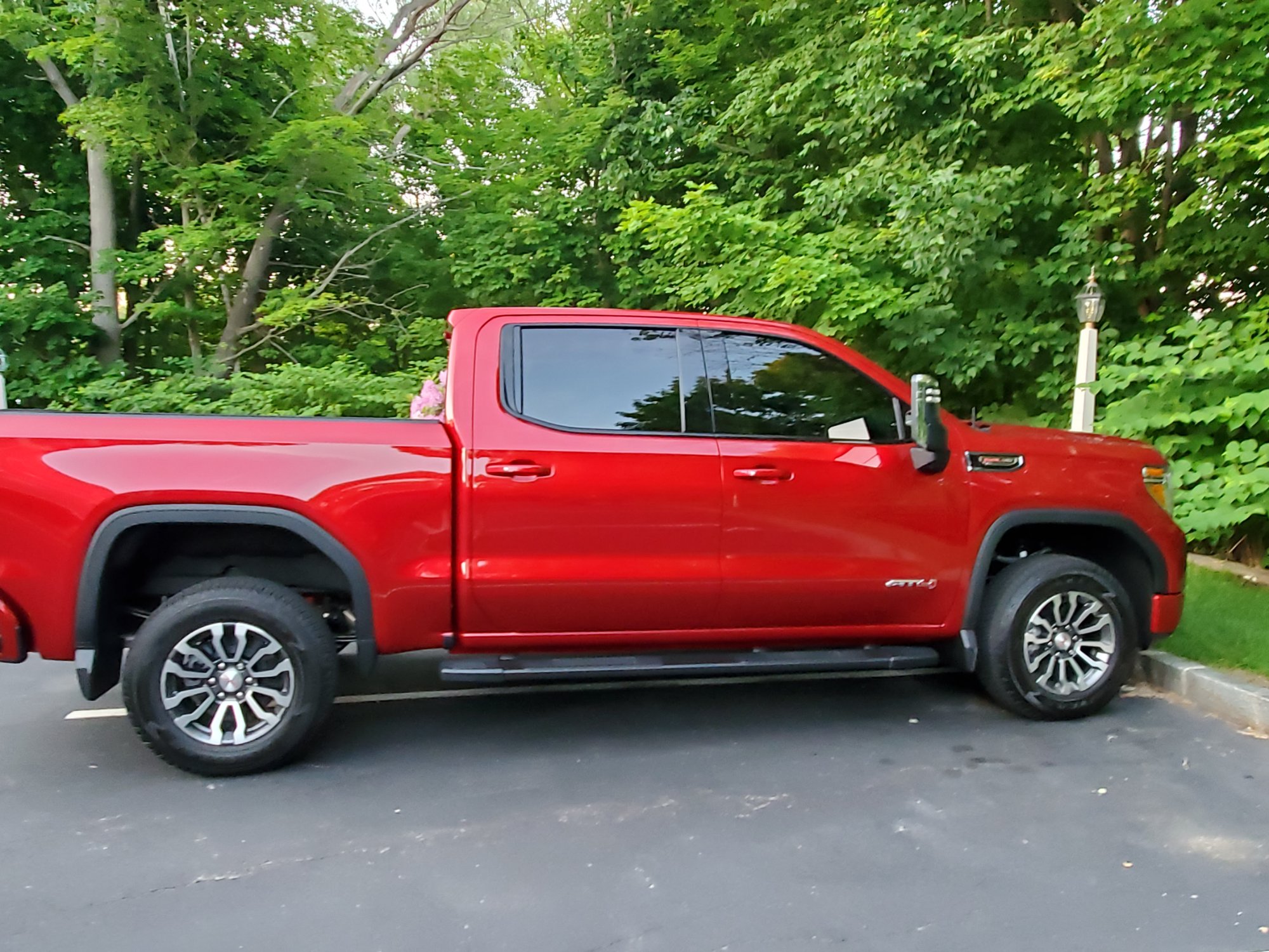

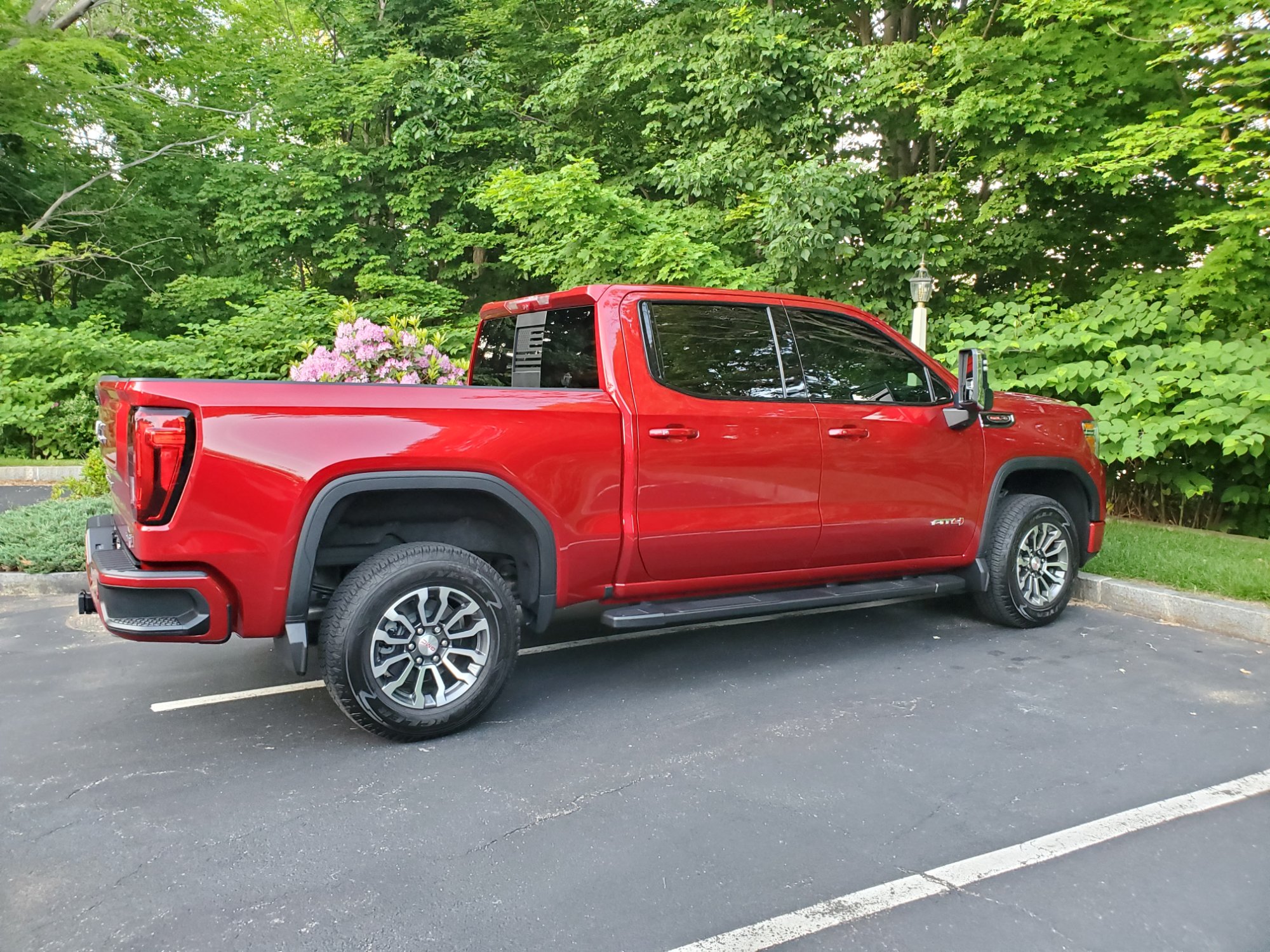

On 6/19/2021 at 3:48 AM, Liquid Plumber AT4 said:
Hi,
I just got a 2021 gmc 1500 AT4 6.2 litre 4WD. Has the stock 18" wheels...which says on factory specs is a 26 offset.....and the good year fortitude ht tires size 265/65/18.
I bought a set of the Fuel Sledge wheels
gloss black/milled size 20"X9" with a +1 offset. I am installing the billstein 6100 coil/strut kit up front and going to set the circlip to #3 setting which should give me a 1.2" front level. Rear shocks will be billstein monotube 5100 series.
Im wondering what is the biggest tire I can run with this new setup? I dont want to do any trimming, cutting or rub UCA (cant get myself to hack up a new truck)......only thing id be open to is cutting that corner piece off on the front inside of bumper that sticks into the wheel well. My options on tires are nitto ridge grapplers size LT275/60R20,
LT 275/65R20, LT285/60R20, and
LT285/65R20 (which i think the diameter might be to big?)......The new TOYO open country AT3 tires....sizes LT275/60R20, LT275/65R20, LT285/60R20, and LT295/60R20... seems the toyos run a little smaller in size on there website than the ridge grapplers do?
Some of these tires are 34" tall.....will anything over a 33" or 33.5" be an issue with that new +1 offset 20"X9" wheel? Any suggestions are greatly appreciated.
Also,  when you guys are going up from the stock 18" wheel and tire to a 20" with bigger tire are you swapping out the spare tire for the same saize? The stock spare is a 17" wheel and 255/60R17 tire.......would I cause damage running a spare tire if i had to with my new wheels and tires im getting? What is the biggest size spare you can fit on the stock spare tire holder setup?
Sorry for all the newbie questions,  but have searched for hours and cant find direct answers to these questions.
Here is a few pics of the truck....I love the truck with the 6.2 litre,  but the stock wheel/tire setup just looks lost on it.
UPDATE: Think im changing the fuel wheels from a +1 offset to the +19 offset. Dont want to be throwing rocks and crap onto the rockers.....finding the GMC paint is very thin.  Plus I think with the +19 offset getting 33.5" or 34" diameter tires on will fit without rubbing or trimming......thoughts??
Thanks again!

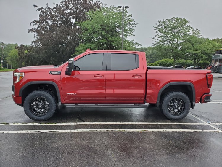

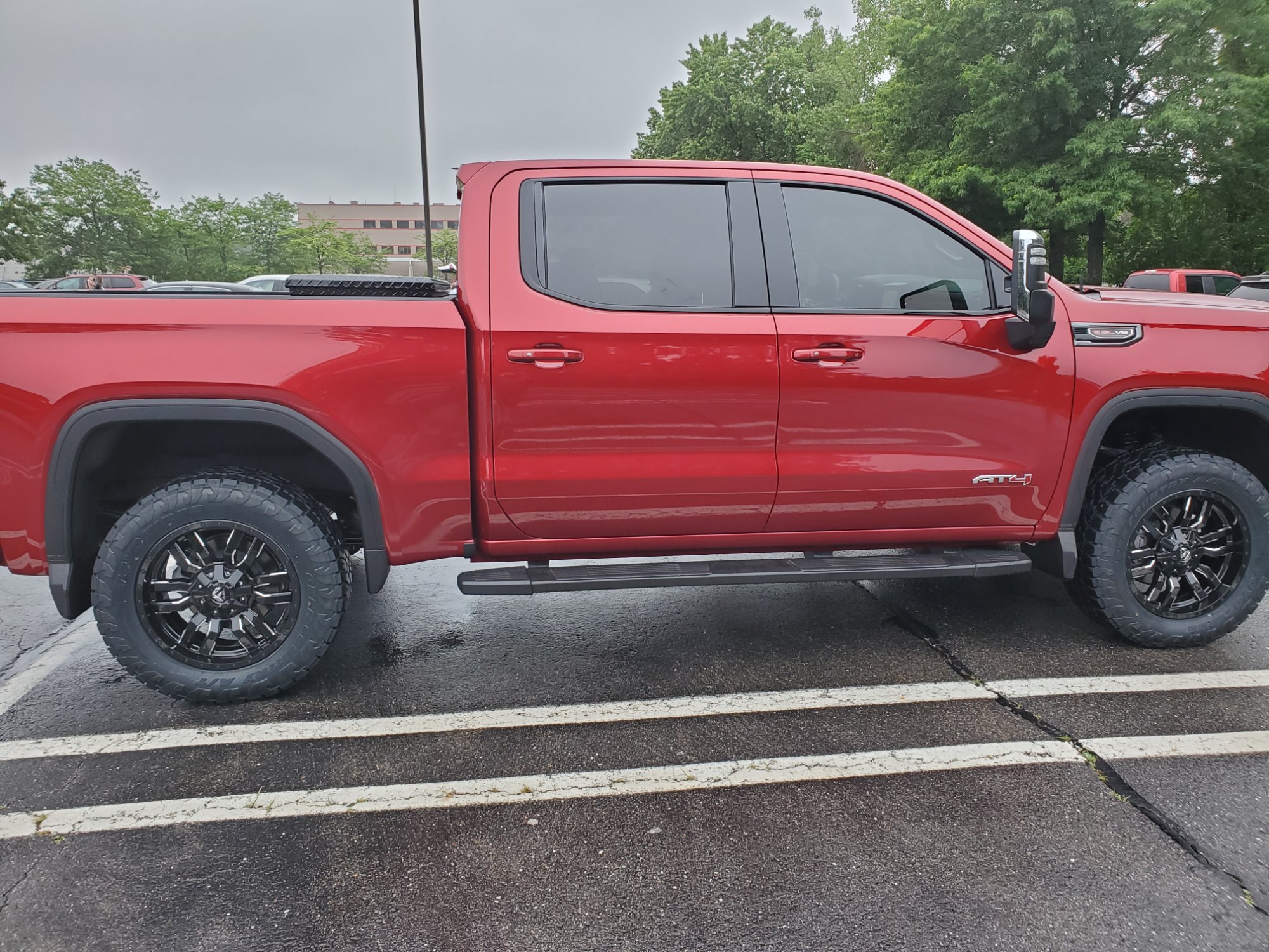

Just got the new setup installed and I really like the way it came out.
Went with the Fuel Sledge 20" X 9" +1 offset gloss black/milled wheel and the Toyo open country AT3 285/60R20 tire. Put the bilstein front coil/strut kit up front which leveled the truck off almost perfect and the bilstein rear shocks which took away that back end bounce feeling over bumps.No trimming at all needed, I get a very slight rub at full turn in reverse on the front splash guard and just barely.....but these are the bigger GMC splash guards. Im going to try to swap the front splash guards back out with the ones that came with the truck to see if it helps, if not I might try those gatorguard mud flaps. Also this setup cleared the A-arm with plenty of clearance.  I have about 3/4" to 1" of poke which is perfect and not to aggressive.
Also swapped out the stock CAI for a Rotofab CAI....excellent quality an fit. I swapped out the chrome exhaust bezels to a set of gloss black powder coated ones from "official powder coat". They also will buy back your stock ones for $50 so it brought the price down to $150 for the set.
I definitely feel like with the bilstein front strut/coil kit which brings it up 1.2" in the front on the #3 circlip setting that a 285/60R20 tire is the max you could do without getting into trimming or having major rubbing. I am very impressed with the toyo open country AT3 tires....they are meaty for an all terrain tire and very quiet. I found the sweet spot is 38 PSI on my truck to run.....toyo recomend 40 to 42 but they rode stiffer at 42.
Here are a few picures of the outcome.
Edited by Liquid Plumber AT4

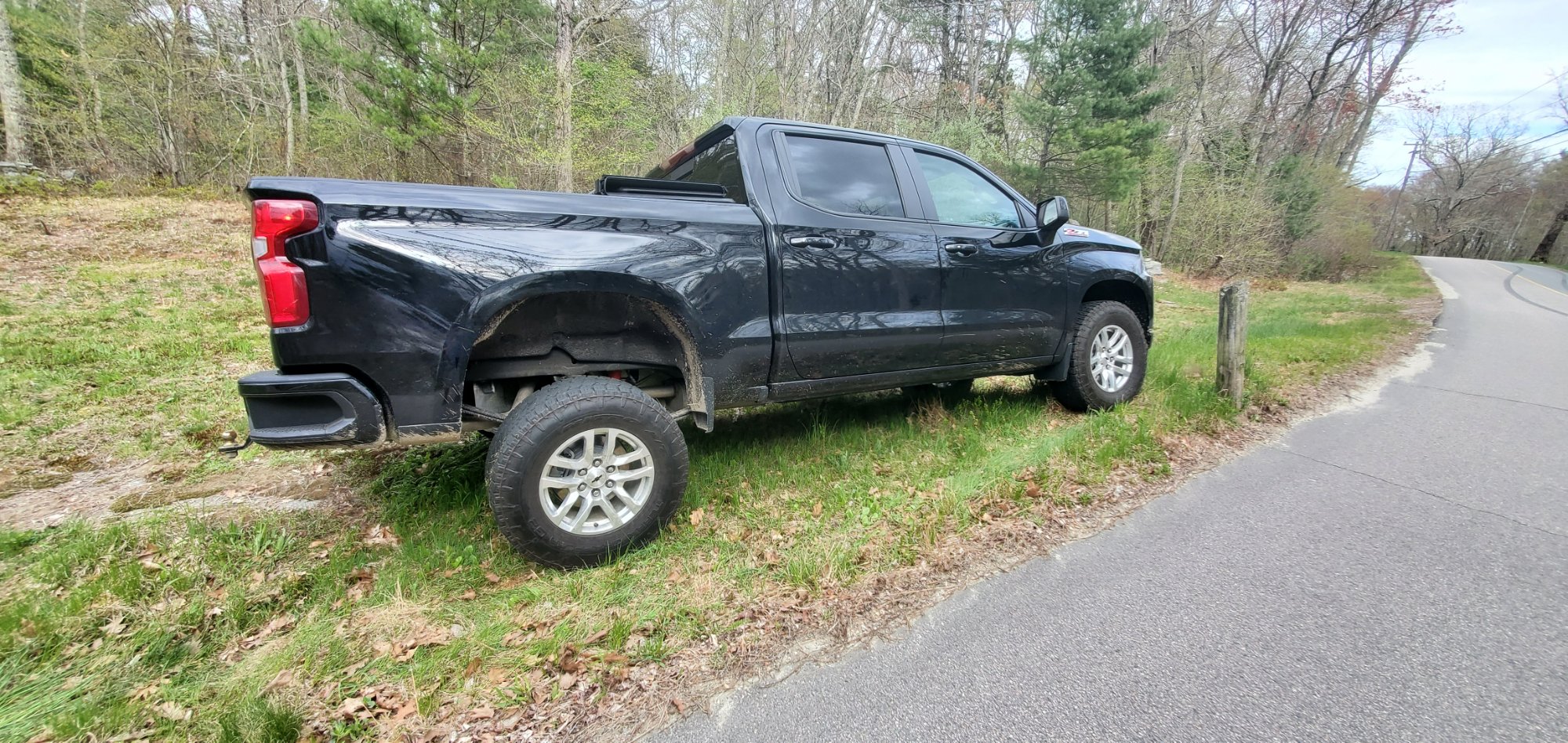

On 5/7/2021 at 11:21 PM, djcrazyphil said:
After reading all of the posts on this thread I decided to try the 295/70/18 on stock wheels on my 2020 rst with the 2 inch Chevy trailboss lift. Tires fit with no rubbing or clearance issues! Thanks for the help guys!
What are we looking at here? Is it just a weird angle and you're in a ditch?
