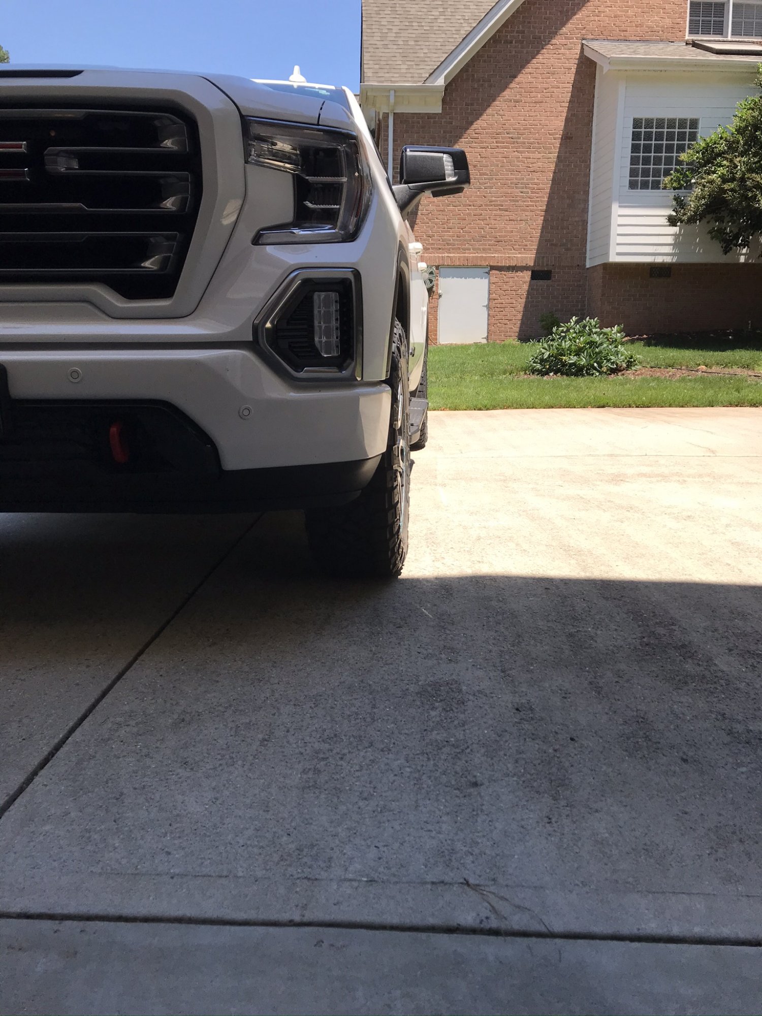

Installed 35x11.5x20 Nitto Ridge Grapplers using factory wheels on my 2019 AT4.  Suspension is stock and so far, appears to be no rub.  Very tight fit though, 12.5’s would definitely rub.

I am considering the same tires for my AT4. Do they stick out of the fender? Any more pics?
Installed the Motofab 1" lower mount level over the weekend.  Unfortunately it did not improve the rub on the passenger side tire.  I suppose i could live with the rub or remove the mounting bracket, but I've decided to drop back down to a 275/70r18.  The 295s would work on the hwy, but allow very little room for any aft travel and I'm concerned with any potential issues once i get the wheel wells caked in mud and ice.  I cant really see how folks are fitting 35s or anything wider than 11.5 on stock AT4s without rubbing - but i suppose all trucks may be a little different.
About the same as oem  tires.

The 295s stick out maybe .25".  Using the OEM 18" rims.  They are rubbing on the top of the passenger mudflap and on the fender liner at lock to the left.  Reverse seems to be worse and of course any sort of incline turning left.  It's relatively minor, but i just dont want to deal with it over time.  No complaints other than the rub with the Grappler G2s for the ~500mi i've had them on.  I hate to lose the 34s - but seems to be the best option.  If i am measuring correctly, the Motofab 1" level only raised things about .75".  I dont think it did much of anything to fix the rub.
Even the tire guy mentioned he had put 35x11.5s on a stock AT4 with no issue...i just dont see it happening, not on this truck.
