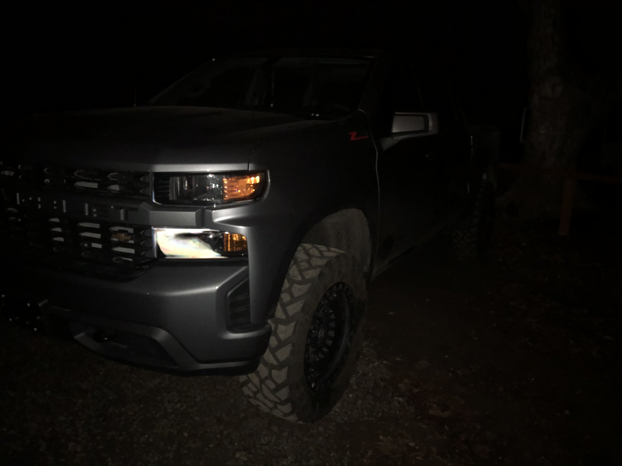

At discount tire now, looked at several tires, going with GY Wrangler UltraTerrain’s in 275/60r20 for $787 installed out the door.  Got $220 credit for the oem  tires that have 750 miles on them.  Will post pics when they are done.
had them side by side with a ridgegrappler, and the Cooper ATP, and the UltraTerrains sat taller, had 5mm more tread depth than the others and looks fantastic, kinda like a Duratrac, but a good bit taller than the 18 inch Duratracs that a lot of the trail bosses come with.
Edited by SquireSCA
Some pics of the new shoes.  Same size as stock, which is 275/60r20, just a chunkier tire...  I had the guy at Discount Tire measure and he didn't think we could go bigger without some rubbing going on...  Tires have tread depth roughly double the stock tires, and only weigh like 6lbs more each, so negligible...
