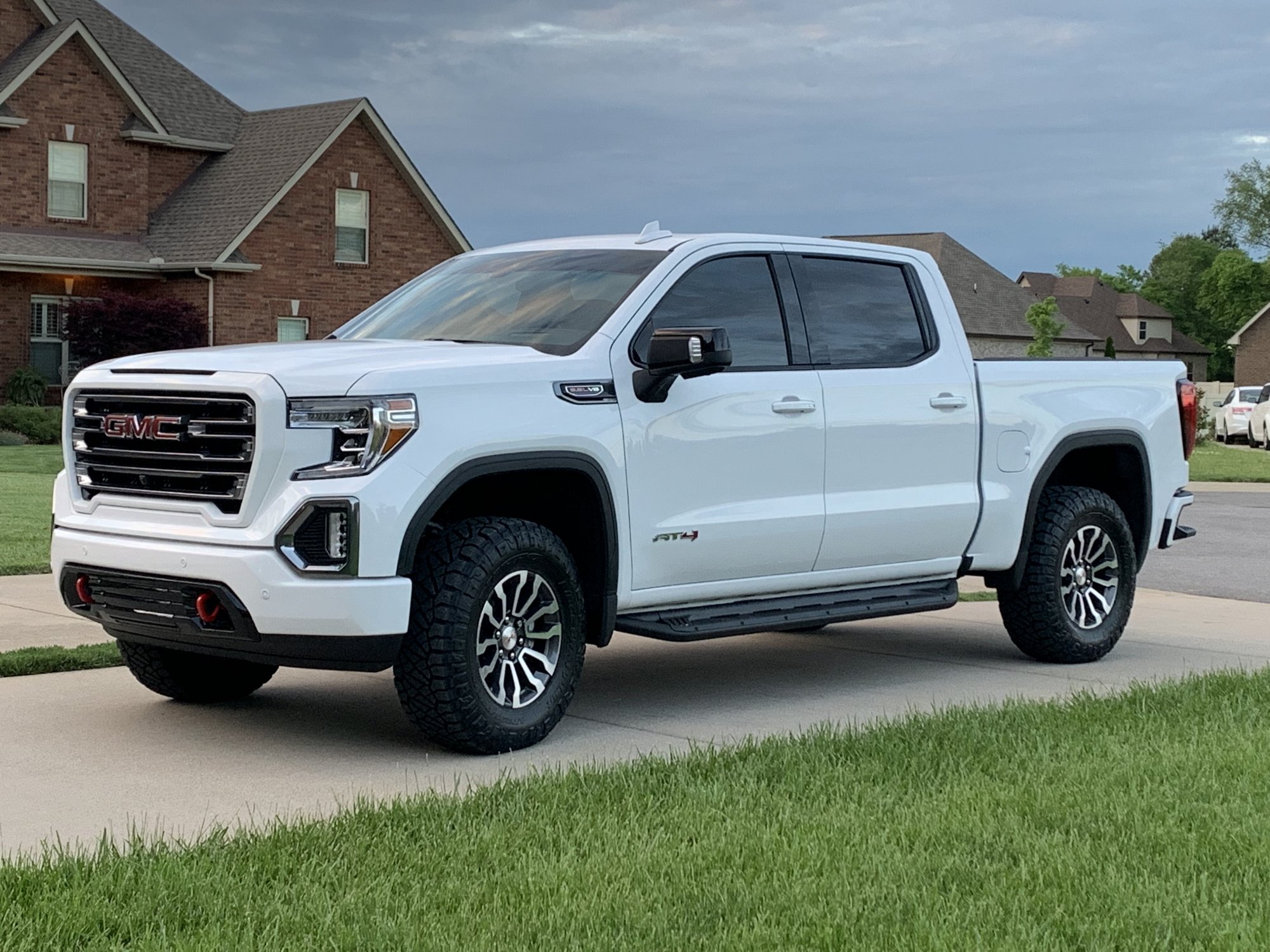

Over all I’m happy with it. No rubbing, I really don’t think bigger would fit. 295/70/18
Looks nice.  Can you describe the ride difference and any other differences from the OE druatracs.  Thanks.
I haven’t really noticed a difference in the ride. The tires are so much better than the Duratrac, The truck just feels more planted if that makes since and much quieter. I did see a slight drop in MPGs I think the ridge Grapplers are about 8#s heavier per tire.

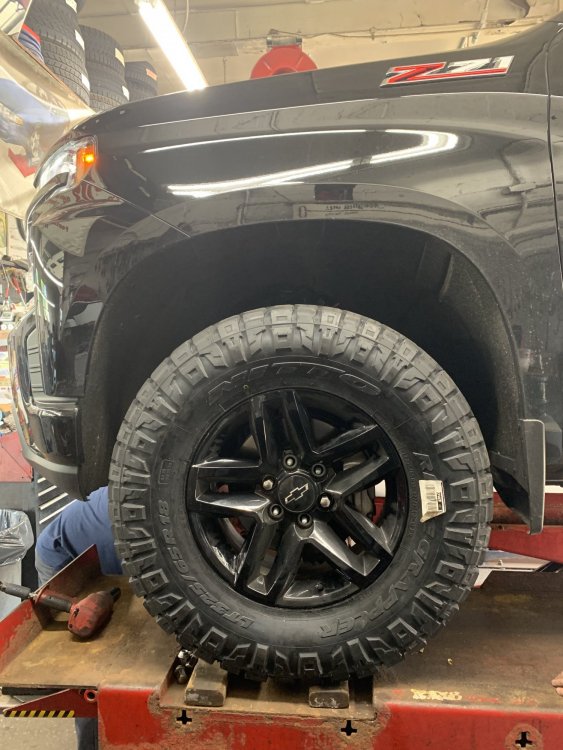

Just installed 325/65/18 on stock rim with 1/4 spacers all around.
Side note:
Front tires did not clear the control arm with this tires (nitto ridge grappler) aka bumpy walls   . So installed the spacers.
Edited by TrailDemon
On 6/7/2019 at 12:41 PM, TrailDemon said:
325/65/18 with 1/4 spacers all around. Front tires did not clear the control arm with this tires (nitto ridge grappler) aka bumpy walls lol.
They fit after the 1/4” spacer or still no. And do you have any leveling kit?
