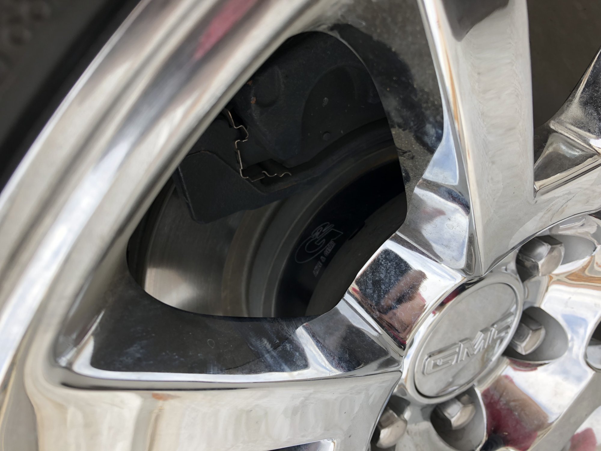

Pulled the trigger on some 1 1/4” spacers for my truck.  Install took about 1.5 hours as I was taking my time, did test fitting at each wheel, made sure everything was clean, then made sure all were installed correctly.  Here’s a pic of how she looks...
1 1/4” spacer need any stud trimming? And I didn’t catch which brand you went with? Nice truck! Perfect stance IMO!
