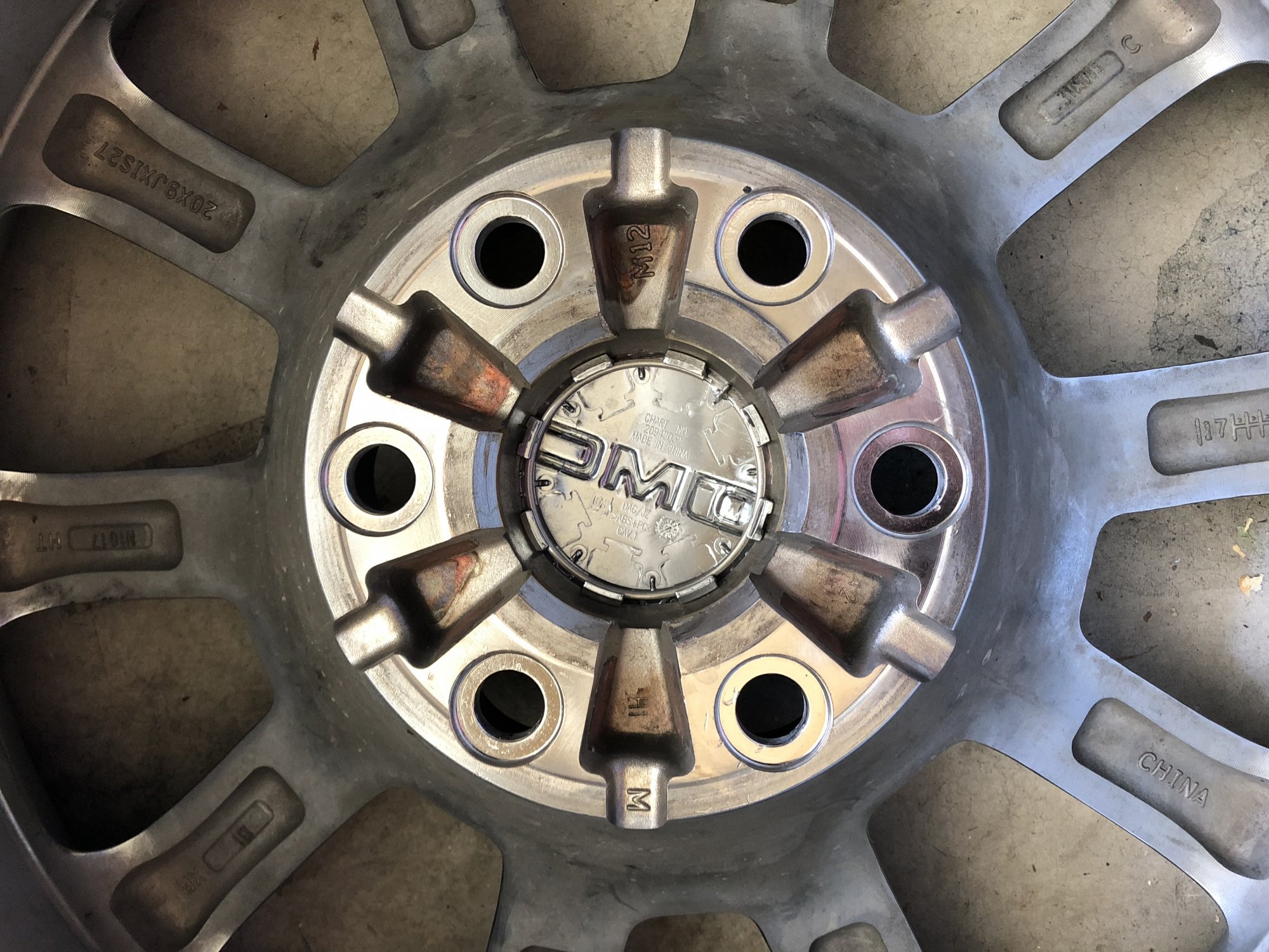

For the record, I removed a wheel & measured the depth of the cavities in the back of my 20” Denali wheels...  a 1” spacer wouldn’t work for me.  The studs are 1 3/4” long & the depth of the cavity is only 1 5/8”.  A 1” spacer would be at least 1/8” short of what’s needed to work.  Here’s a pic of what the back of my wheels look like...   I decided to go with 1 1/4” spacers & they’re exactly what I was looking for.

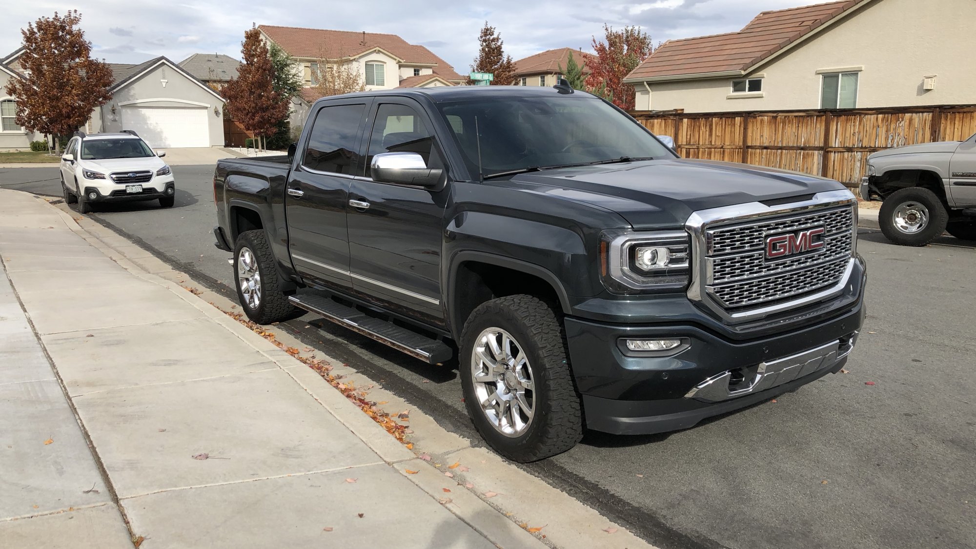

Pulled the trigger on some 1 1/4” spacers for my truck.  Install took about 1.5 hours as I was taking my time, did test fitting at each wheel, made sure everything was clean, then made sure all were installed correctly.  Here’s a pic of how she looks...

With a 1" spacer you need 3/4" deep pockets, correct?  I'll have to measure my wheels.  I kind of like not destroying my feet ders with rock chips though...hmmmm
No, slightly bigger with 285/55r20 which are about 3/4” taller & 1/2” wider than 275/55r20’s.  On the truck my BFGs are nearly an inch taller than the stock Goodyear SRAs it came with.
With a 1” spacer, yes you’d need a wheel with 3/4” deep pockets or more.  The other option would be to trim the end of the stud some.  There is room to do that as there’s about 1/2” of stud length that’s not threaded or used.
