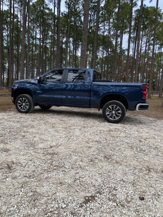

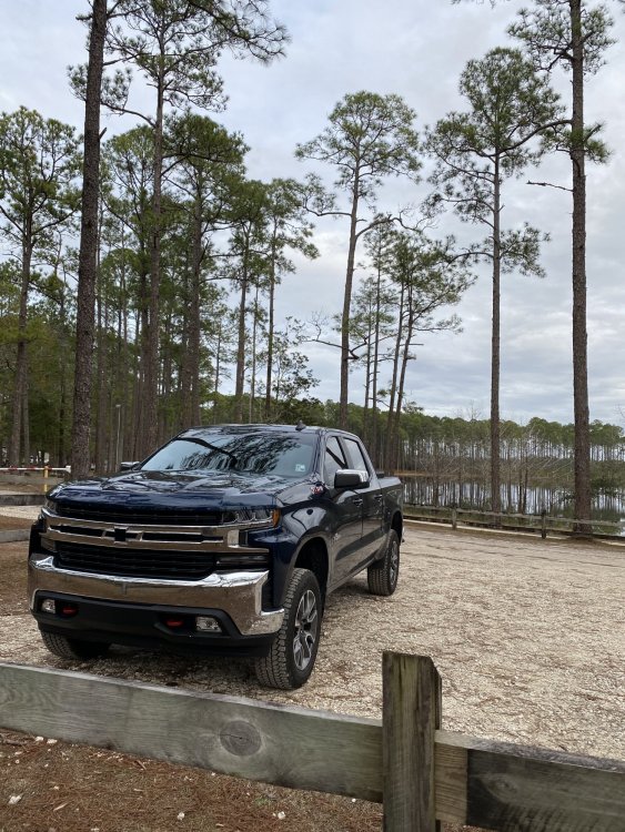

Finished everything up. Had to make my appointment for the alignment next Friday due to shipment delays. 1.5 motofab & 35 12.50 18 Ridge Grapplers with 2" Bora spacers.
