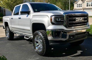

BDS 6" lift and Fox Coilovers set at 4.5in of lift in front to keep 2" of rake.  BDS rear leaf springs stock 20" whee ls 35x12.5 Toyo Open Country RT no rubbing.
