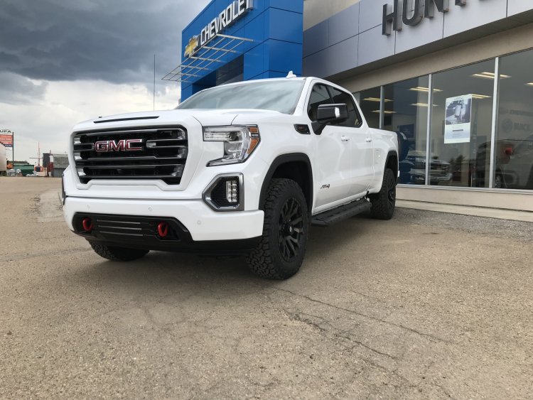

Congrats Nik;  looks great eh...haha.  Fellow Canuck here.  Haven’t seen too many long box models in the crew cabs.  Love your wheel choice.  Any clearance issues or rubbing?

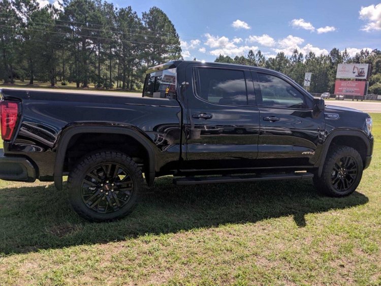

2019 AT4,   Readylift 2" front level and 3" blocks in rear to keep a small rake...   Vision 18x8.5 0mm offset w same tires Duratracs 275 65 R18
