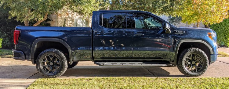

2019 AT4 with 20x10 -24 wheels.  Nitto RG 33x12.5x20.  2” Rough Country level. Stick out a little further than I wanted but I do really like the aggressive look.  Required a bit of trimming on the plastic but no more rubbing now!
Looks great, do you have any photos from the side and the rear/side?
