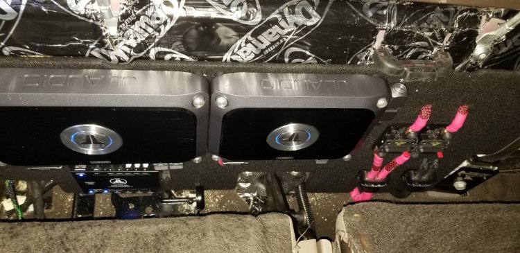

I went a little crazy. Nav-TV makes a perfect high quality adapter to get true optical audio out of the head unit. And it keeps your chimes at the volume where they should be. I have Focal yellow 3 way in front. Focal yellow 2 way in the rear. Single 12 jl audio shallow mount under rear seat. 8 channel 800/8 vxi jl audio running active for the front 6 channels and passive for the rear 2 channels.  Single channel jl 600/1 vxi jl audio for the sub. Also the optical hub so i can hook the laptop up and do easy tuning of the system. Second battery under the hood in factory location. Lots of dynamat. Lots of good 2/0 power and ground cable. This pic is of it right before i finished so it doesnt have to cover on the top and its dirty. I dont know how to get more pics on here or i would.

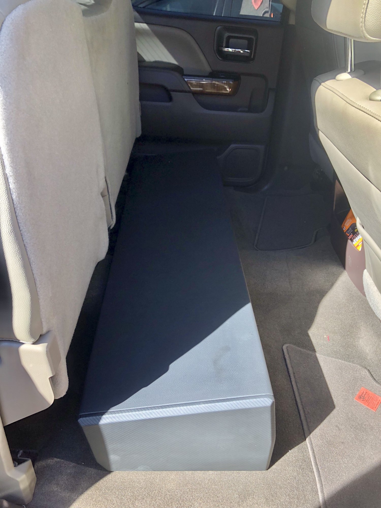

I have the stock bose, however I just threw in 2 10” jl tw3s in a sealed box pushed by a jx 1000/1, and it hits preety good. Went with a audiocontrol lc2 converter, and a Rockford fosgate cap. The bose sounds great with it, but when it’s time to upgrade them I’m going with focals. Don’t have a great pic, but this is what I took when I got home.

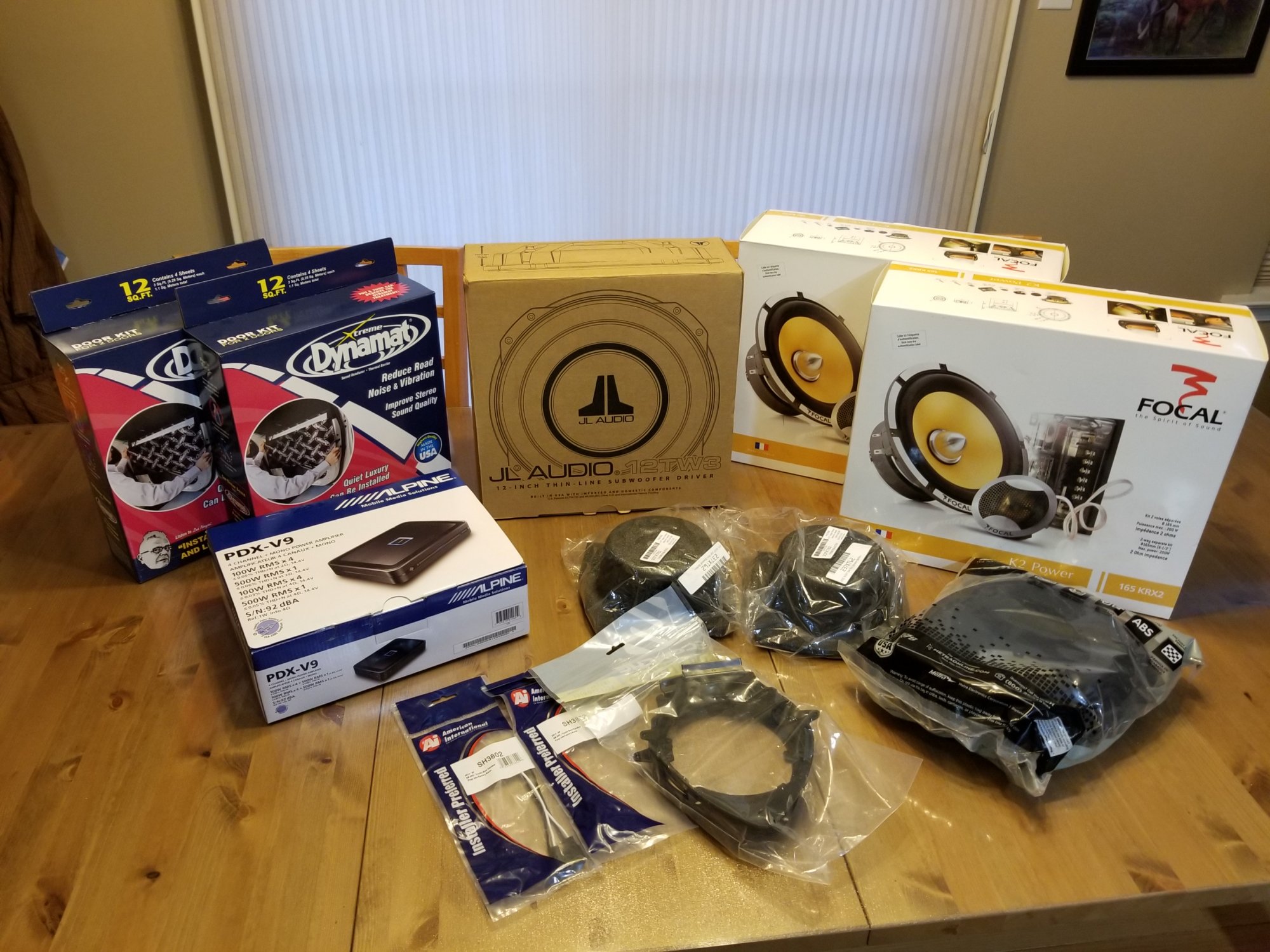

I went pretty simple.  Came out of stock head into Alpine PXE processor, into alpine X-a90v 5 channel amp, changed out all speakers, and added JBL shallow sub.  Nothing to big but sounds good.  Started out with club 4505 amp which is in pic, but wanted a little more out of it.  Everything we added is in the box under back seat.

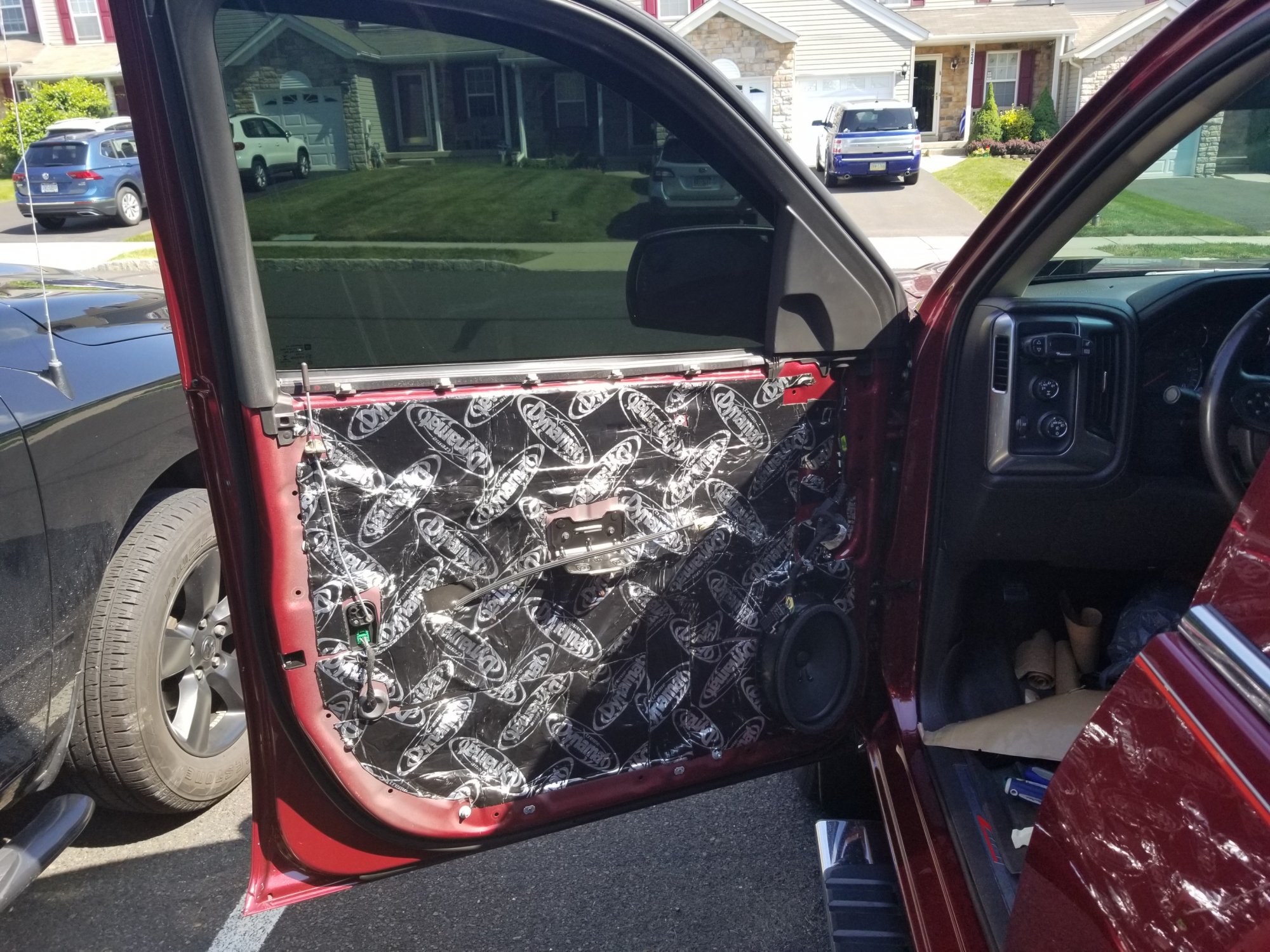

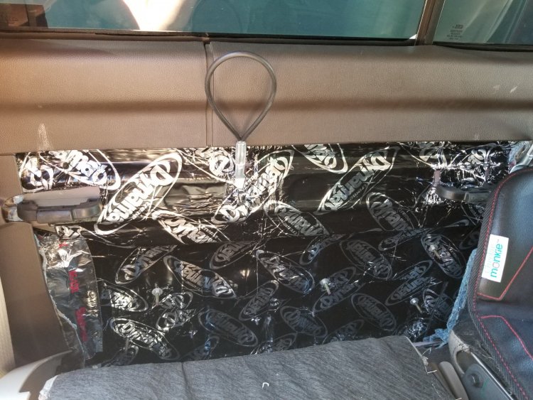

Thanks. The pic i posted doesnt have the top cover panel I made. So it kinda looks unfinished. Its about $7k by the time i add up everything. Some people would never even tell the difference and would think its factory. I spent alot of time and money to do it once and do it right. The best thing i did was to dynamat the whole truck. And i mean almost everything except the front firewall. You cant see, but even the outer skin on the doors is completely covered with dynamat. Also did side pillars and roof. So worth it. The truck is so tight and its a dream driving down the road. When the truck is closed up and the A/C is on, you can actually feel the pressure coming out of the outside door handles.
