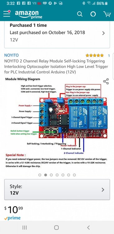

Hmm. Im out... hopefully Pgamboa or tinkeringfox will chime in now. Alot of people said that there was no programming needed. Since mine is a 14, its not possible for me anyway. I used a latching relay so there was no bcm integration needed. It works perfectly.

To repost again for those who cant get theirs to work through the BCM, I posted on page 13 how to wire up the latching relay shown above this post.  Mine works perfectly and is a instant on and off. No long press..
