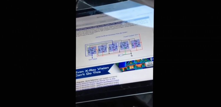

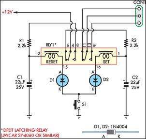

So ive been looking at ways to change a single pulse signal to a constant signal using a few relays. But the way i saw you can latch the relay but it cant be unlatched until power or ground is removeď.  The other way to do it and get it to work perfectly uses 5, yes, 5 relays all wired up a certain way. Im not sure that that is what i wanna have under the hood all to have a fog light switch work.
Thats a screenshot from the video i saw.
