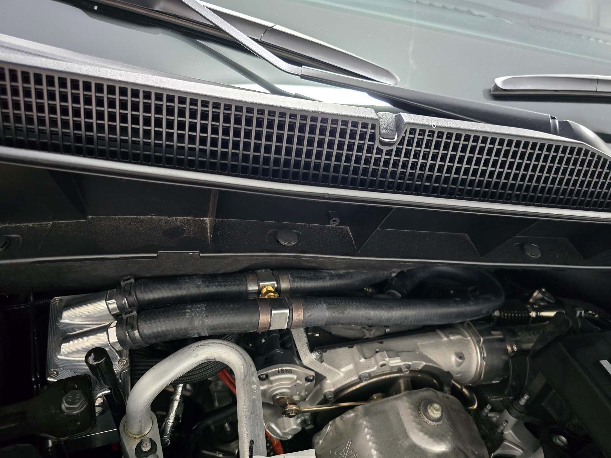

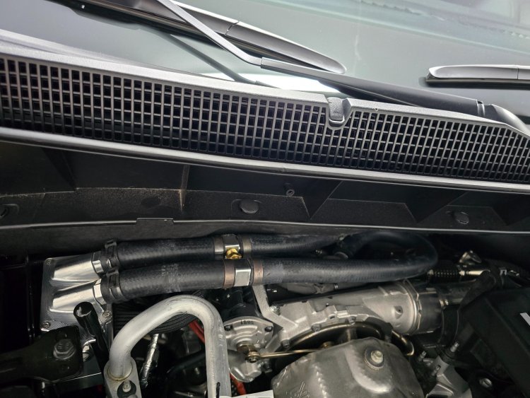

How many miles on it?
Was yours using oil?
Did you take off the inner cooler and clean it out and if you did how much oil did you find?
thank you
thank you
My LZ0 has 1,200 miles since November when I bought it. My previous LM2's that I've had, had considerable oil in the turbo outlet. Demon Works on YouTube has a video where he poured oil out of his charge air cooler. The design of the crankcase ventilation and having it routed back into the turbo and then the charge air cooler will condense the vapors back into a liquid, this collecting in the charge air cooler.
