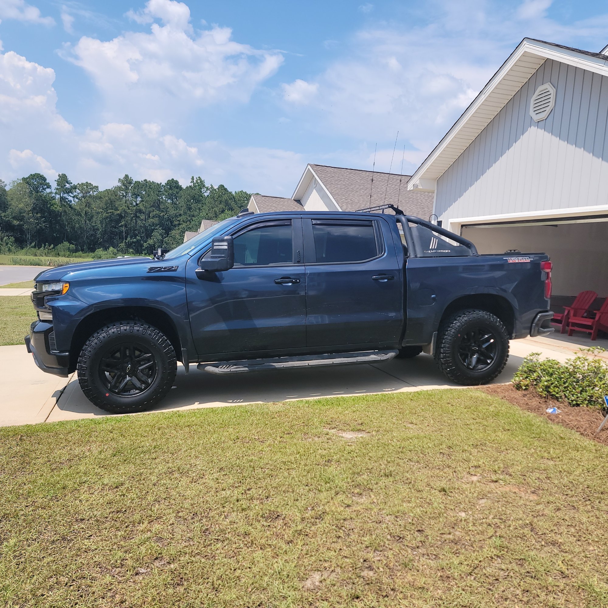

Today I put a Fox suspension under my truck.  Fox 2.0 coil overs up front set at 2 inches of lift at fox 2.0 shocks in the rear with Supreme suspensions 2-inch blocks.  I also put on the black Trail Boss style wheels and Goodyear Ultraterrain AT tires.  I almost forgot we changed out the OEM chrome running boards for these black ones.  I had already done the blacked-out badging, Borla touring catback, and an S&B cold air intake.  My truck is a 2022 refresh RST 6.2 I bought it new in January.Foxlift2.thumb.jpg.e7425bde6a851c31d2be9bd86edc4324.jpg
Where did you get the black badging? Love the before and after pics. Truck looks awesome!

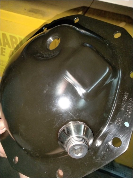

Hello all.  So, my ‘20 trail boss got a new front differential cover this afternoon. I have the 8.25” front differential, supplier SU5 (AAM).
sorry, the above picture is upside down…I was laying on my back in the driveway and thought about it last second.
No, it doesn’t leak.
I started with a factory cover from GMPartsDirect.com, and ordered a 1/2” NPT Allstar Performance weld-in steel drain plug and bung on Amazon.
my brother works with a welder (professional, welded at Dominion Energy for 30 years), and they MIG welded it from the inside.
after I got it home, it was time to tap out the bung a little more to get the plug to sink into the bung a little further and be flush on the outside. At its current location, the neodymium magnet clears the ring gear by 1/4”. I fastened the magnet to the drain plug with Loctite 638 retaining compound.
if it weren’t for the three top bolts being next to impossible to remove, it would have gotten done much quicker than the 3 hours it took me. I used 1.57 quarts of LucasOil Synthetic, 80w-90 gear oil (red and black bottle). Torqued the fasteners in a cross-cross pattern to 18 ft.-lbs. like the service manual calls for. After bolting the skid plate back on, I’m on to the next project.
Now that is some great work!!!!

Thank you, Mshawn. I can’t take all the credit. It’s not all my doing. I just installed the cover, adhered the magnet to the drain plug, and tapped the bung for the plug to go in deeper. Just as a bit of info I’ve discovered, I believe all the trail bosses between ‘19 and ‘21.5 have the same front differential.

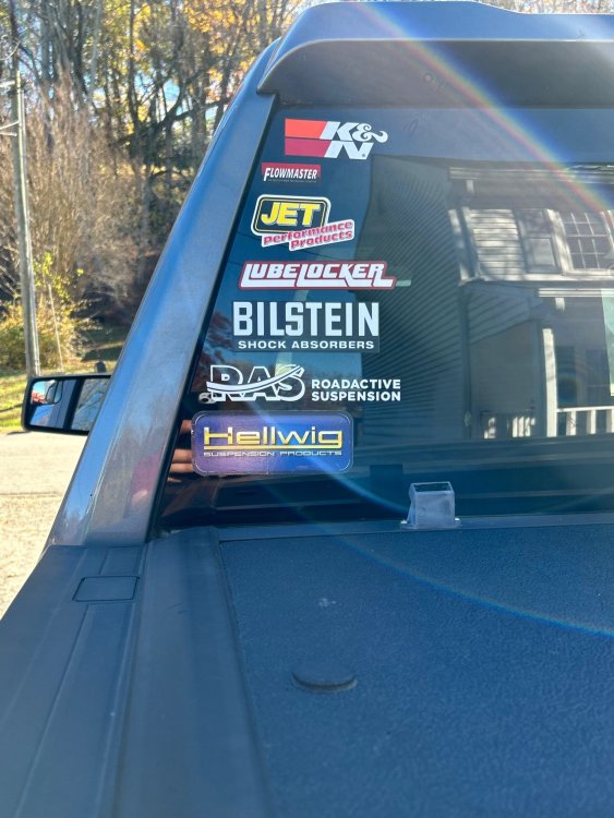

So, here lately, I’ve added RoadActive Suspension, Powerstop z36 Extreme carbon ceramic pads and drilled/slotted rotors, and the Hellwig 1.125” rear sway bar. After the dual exhaust, these were the last things on my list to improve performance on my 4.3 Custom Trail Boss for towing my grandfather’s enclosed trailer and flat track Triumph TR6 to the track in the spring and summer. It rides really nice because of the Baja Boss A/T’s minimal road noise and the Bilstein 5100 shocks and struts….the engine sounds fantastic with a flow master Super 44 and 2.5” pipes singing from the back, paired with a K&N air intake (modified from a V8 application), and the interior is extremely comfortable, yet sporty with the leather and carbon fiber trim….paired with a storage console and high country instrument cluster and dash, I have no doubt that this truck is now truly a “Custom” Trail Boss. I love it.

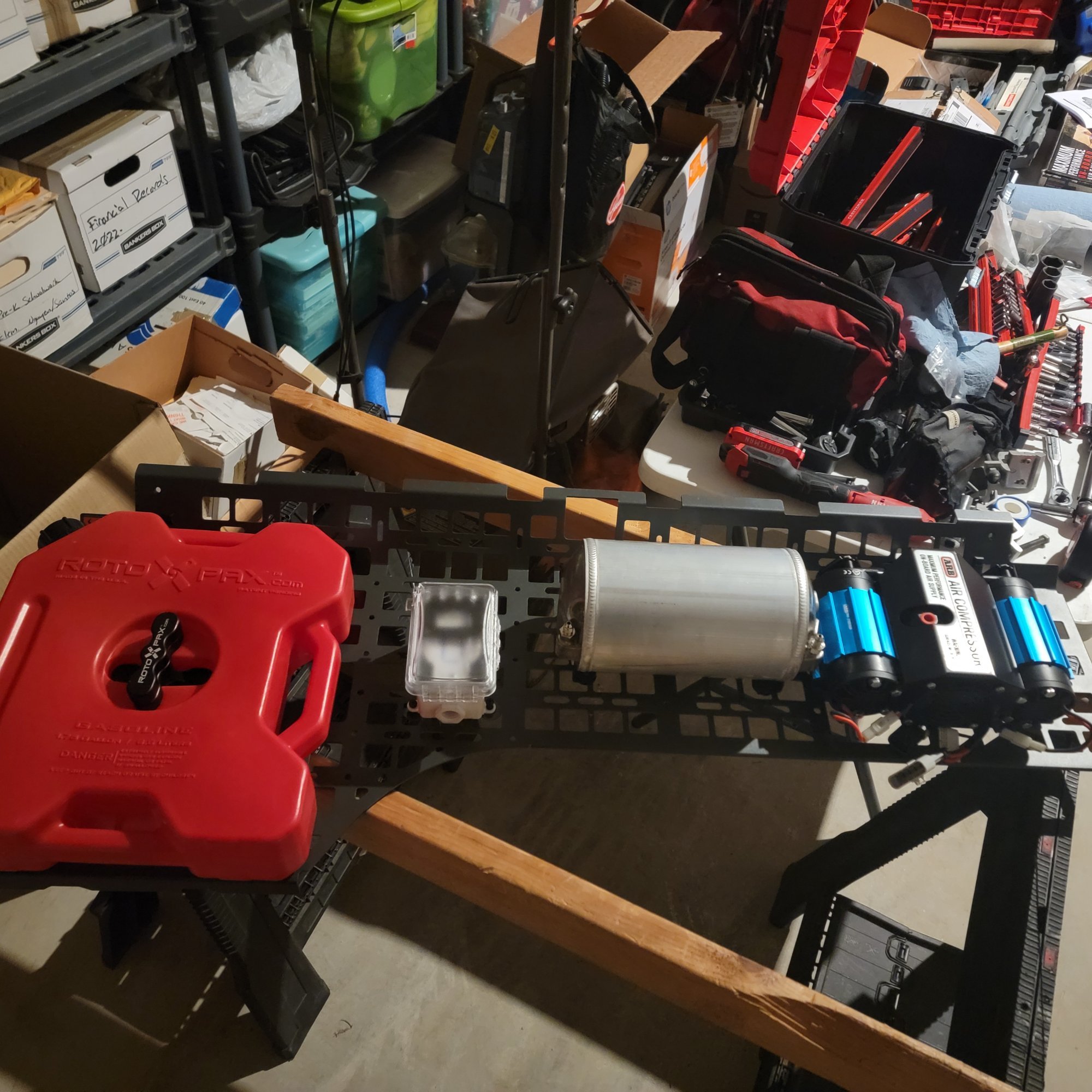

Time for the next project.  Working on the Vallhalla Offroad molle panel I have on the drivers side of the truck bed.  I'm installing an ARB air compressor with 1 gallon tank, and mounting the switch on the panel too.  This is day 1.  I'm not certain about the orientation of the air tank.  The gas can is 1.75 gallons.  I always have 2 of them located in the spot you see the 1 in the pic.  The location of the air compressor is where it'll be permanently.
