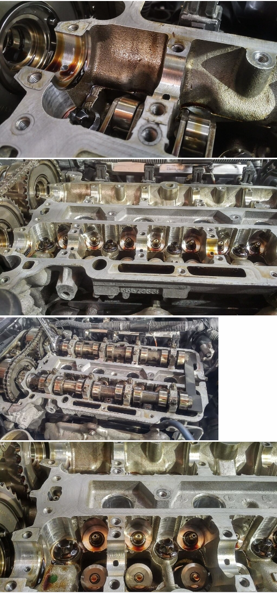

Found some photos on a Facebook oil group.  Thought this was pretty impressive.
"2012 Cruze Eco 1.4L Turbo. This car has seen nothing but AMSOIL Signature Series 5W-30 since 2013, and has been tuned since as well, first with Trifecta then with BNR, making about 50hp and 70lb-ft more power *to the wheels.* Starting in about 2015, the car was used to tow my 14' boat as well as my utility trailer and various uhaul trailers. Since I started working from home full time in 2015, most of the driving was short trips, wide open throttle to redline daily.
At 72k miles, I pulled the cams to upgrade valve springs. The oil in service at the time of this disassembly had 12,500 miles and 2 years on it, about 1/4 of which was with a trailer behind it and the rest of it hitting max boost daily. I stopped caring about fuel economy once I stopped commuting. The oil change prior to that went 15,622 miles and 18 months, and all oil changes before that were at 10,000-15,000 miles (dealer drained it a couple times to service the oil pan and PCV system or they'd all have been 15k miles)."

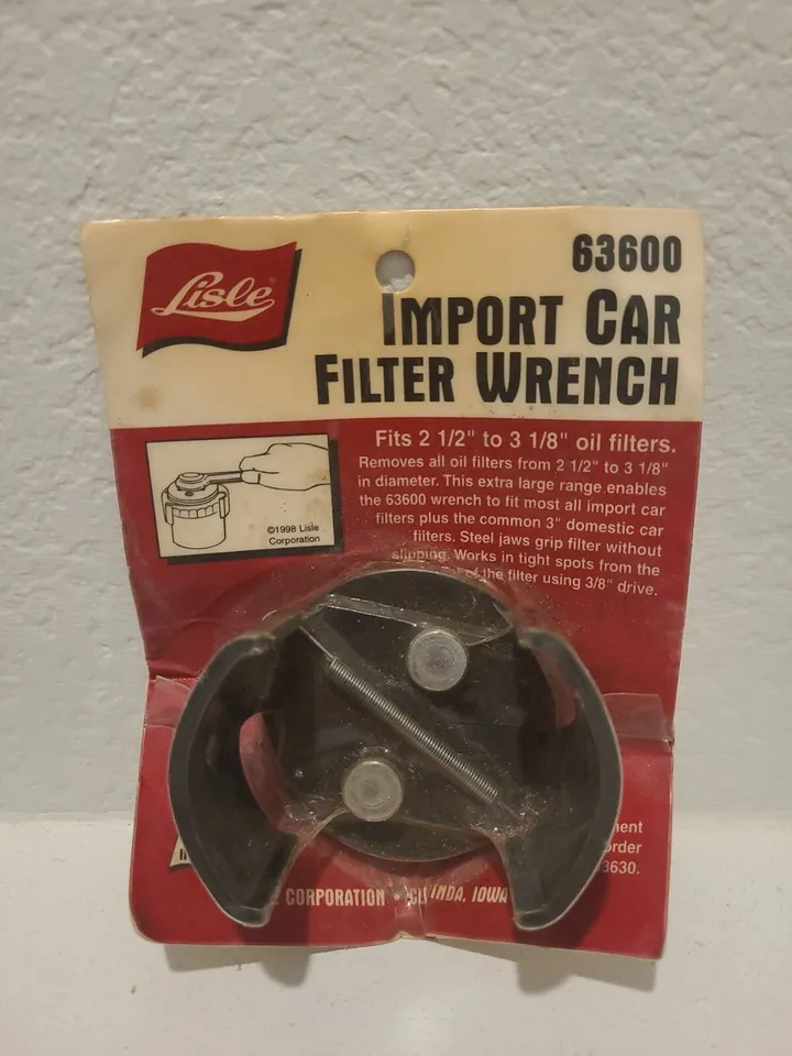

Used new Lisle "import car" oil filter removal wrench from O'Reillys--worked great 👇🏼

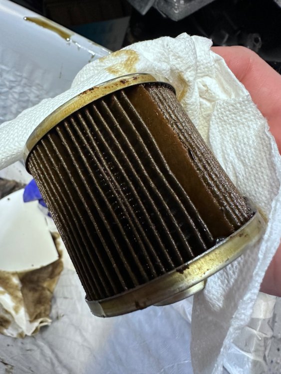

2018 Jeep, 77,322 total miles, 2,285 on interval. Drained out F&F & HPL EC, installed 5.5 quarts HPL Premium Plus 5w30, Fram XG10060 filter.
HPL EC was doing its job. Oil was dirty dirty dirty black (my scientific term) but no chunks in the filter. Car was obviously well maintained. IMG_3721.thumb.jpeg.4d06acca94a64f0b3feef3f643822542.jpegIMG_3724.thumb.jpeg.68d340dba9d598b0719ebfb3cca27882.jpeg
