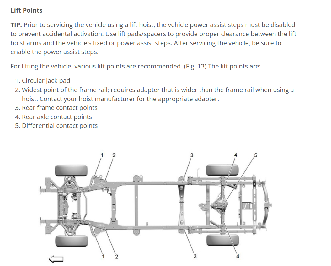

There's a issue being claimed on Facebook that the new frames are susceptible to being bent if the trucks are not lifted correctly. The problem is the wider frames are also thinner... and require a wider puck for lifts. Which most people don't have?  Part of the claim is that a 2019 even fell off a lift because of this issue.
Has anyone else heard anything close to this? I can see how this might be plausible (new frames needing a special wide pucks) but I'm skeptical about frames actually bending and there being a "big issue".

Take some pictures of the crack/damage and post it on here. Write it off? Frames can be welded and repaired.
3 hours ago, redwngr said:
Since this old thread has been brought back to life....
... correct pads are needed.
If you don't have the correct equipment and lift something wrong it can cause damage.
