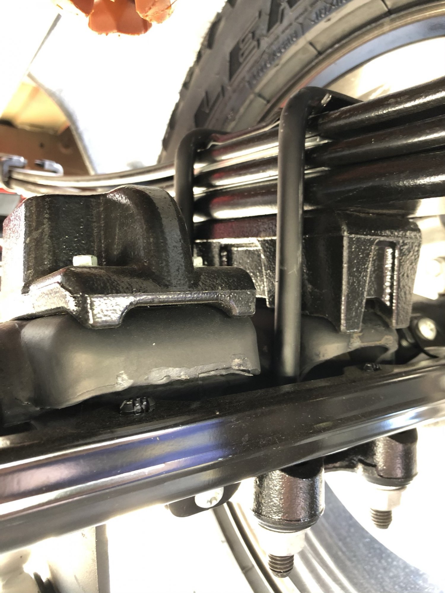

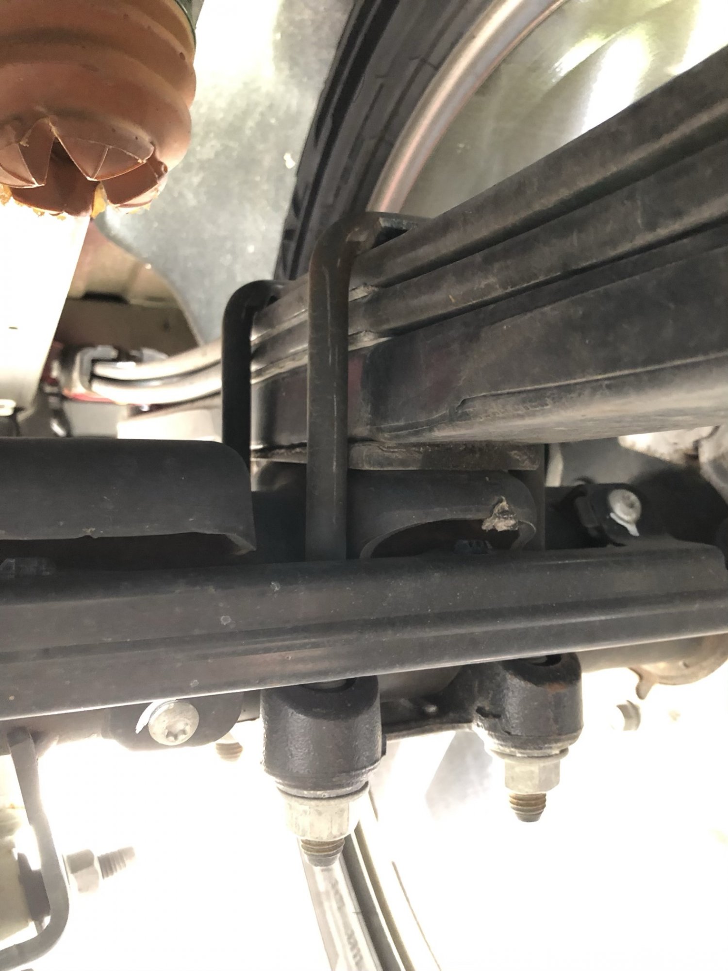

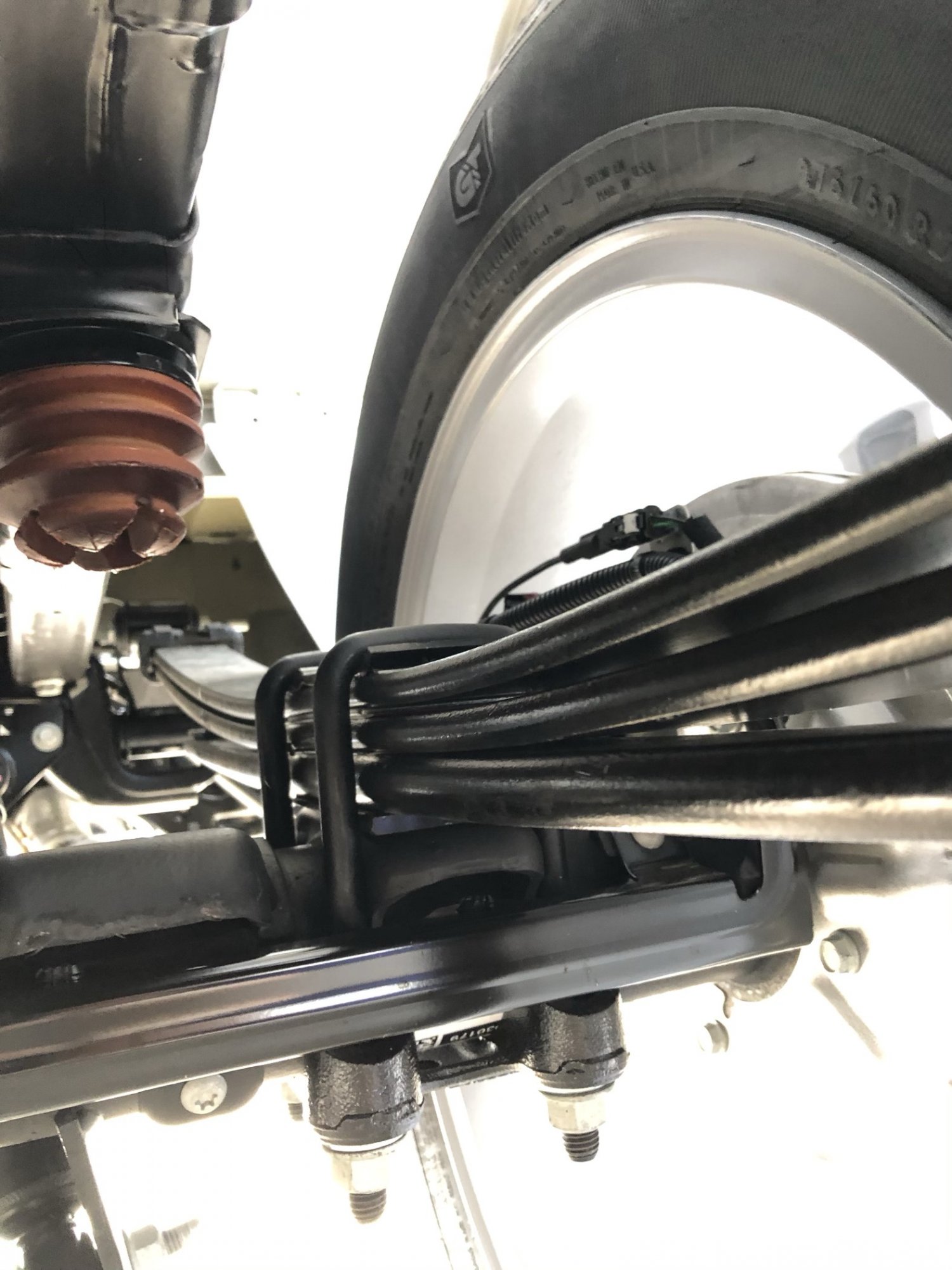

Went to the dealer and took some photos of the leaf spring mounting area of a Trail Boss, a standard all-steel leaf from a Custom, and then my LT with the composite leaf.
I’ve attached pictures below. I can’t see why you couldn’t have the trail boss lift installed on a composite leaf system.
The only reason I can see is that the composite leaf already makes the rear sit higher than with a standard, all-steel leaf system. If you look at the picture, the composite leaf is as thick as both of the two steel leafs stacked on top. This means a trail boss lift would make an LT 5.3L sit even higher in the rear than a factory trail boss! Not by much (maybe 1/4”), but maybe enough to affect the shock absorber travel.

Did you get the height of the composite leaf spring? It looks a little taller but other than that everything on the TB kit looks like it would work.

Like a dummy, I did not bring my measure with me to record the heights of the TB and standard springs. I will measure my composite tomorrow and if I have time, go back and measure the other two and post on here.

The height of the stack with composite is 2.22”. The height of just the composite leaf is 0.97”.
I couldn't get to the dealer to measure the others today.
