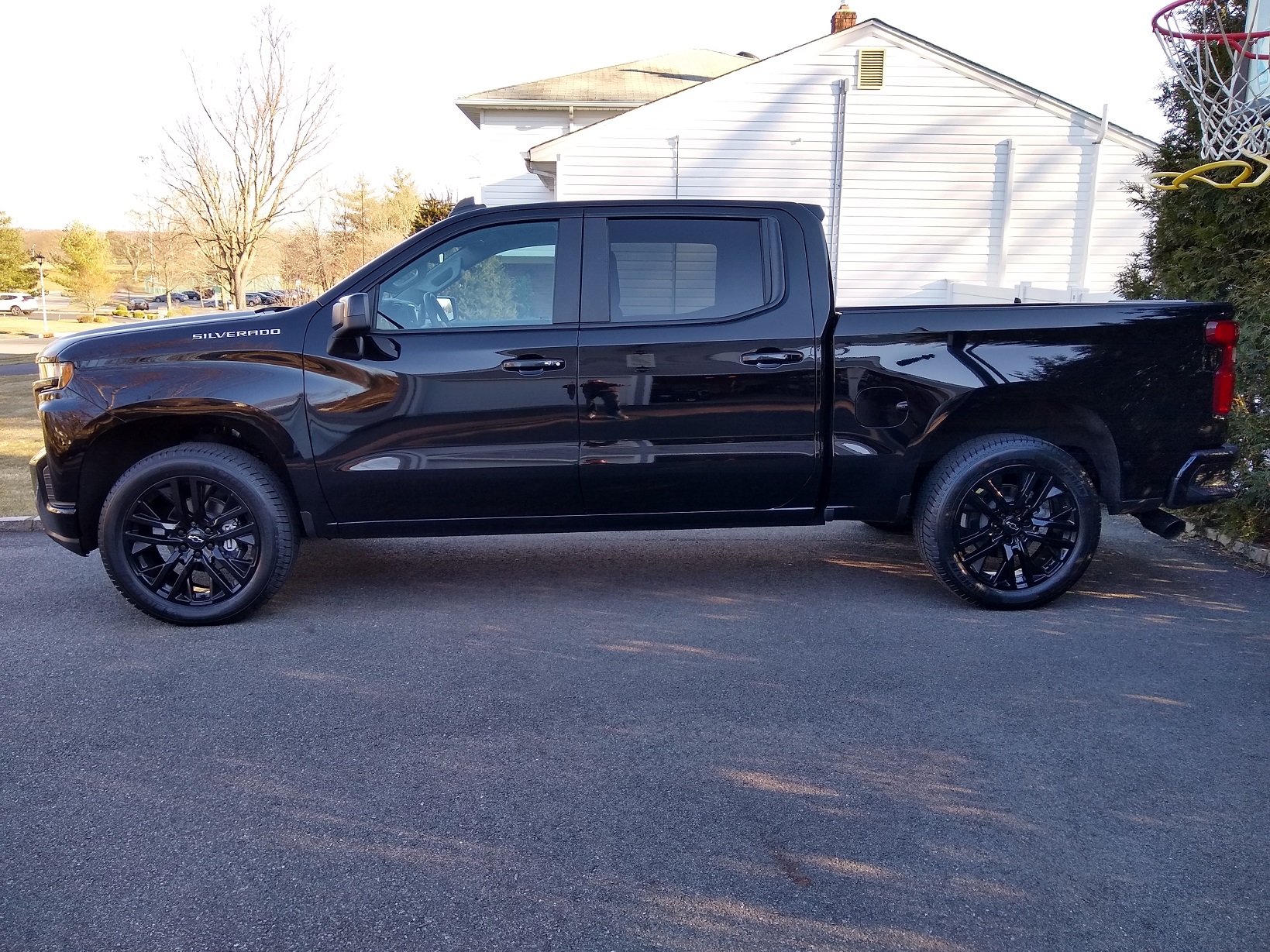

I just got a set of Cooper Discoverer AT3 4s installed in 285/45/r22 a few weeks ago and they have been great. I think they look better then the stock tires, no difference in road noise and seem to be better in the rain. They are 3 peak mountain rated but won't be running them in the snow as I have snow tires.
