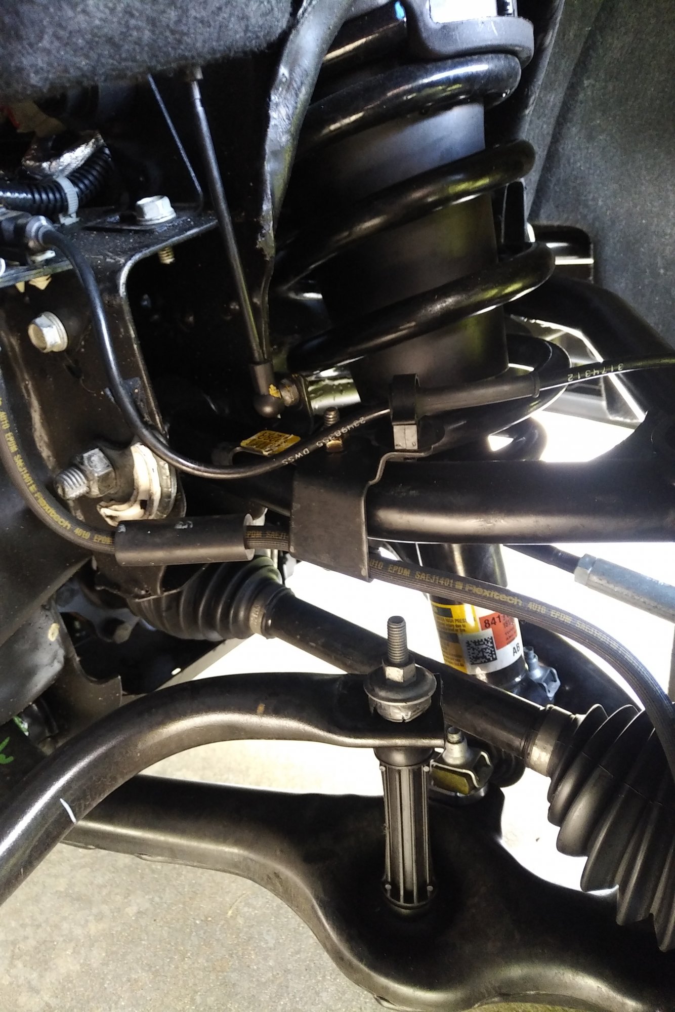

Readylift tubular upper control arms and spacers installed. Raised the front end 2.25" Stock rear with stock 285-45/R22 Bridgestones (for now).
Love the new stance and the ride is great.
I had intended to use another company's relocation brackets for the magneride (Readylift doesn't make one) however after installation, the thicker tubular UCA placed the ride sensors right back in the stock position. No relocation bracket needed.  I couldn't be happier with the new setup. 07d6a08f7348f55a3bf1c237745d972c.jpg
