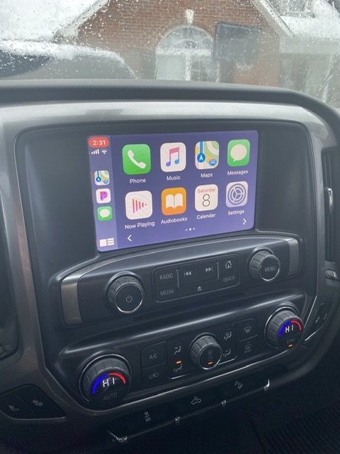

Finished up mine in my 2015. I’ve got less than $300 in everything, so I am satisfied.

If you go by what WAMS says to do, it works perfectly. Make sure you buy the appropriate hardware (radio module and HMI), or get the new hardware from WAMS with a warranty on the electronics.  Chris did a fantastic job programming it for my truck, and I couldn’t be happier. I swapped to the IO6 HMI with navigation and the HMI is unlocked from WAMS. My cluster was also programmed so I can use Siri from the steering wheel. If you do go that route, I’d highly recommend getting the harness from HarnessDr.com so you can use your rear camera while in drive to check on trailers, or anything behind you.

The only thing that doesn’t work On my truck is the speak button on the steering wheel. I knew that wouldn’t work without going with a Denali cluster or having mine reprogrammed. I never use Siri anyways, so it isn’t a big deal to me.

If you got all new hardware and did the cluster upgrade it would be $1000 easy. I bought used hardware and had it programmed, so I’m in it for much less. The HMI was the most expensive part, and I got it for $125 (link provided in previous post)

Chris was really nice and he answered all my questions. He also said the 84331775 HMI isn’t currently on the matrix, but they can program it without issue if needed.

If your streaming music from your phone, you can’t skip tracks with the steering wheel controls either. Once it’s programmed, it’ll work 100%.
