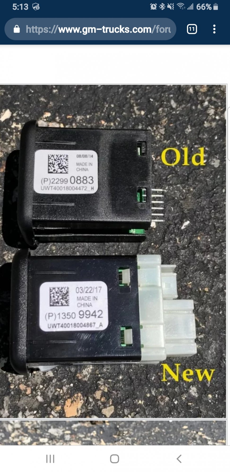

Need to replace my USB port in the center console to finish CarPlay upgrade.  Anyone know who I can order from and what is a reasonable amount?
