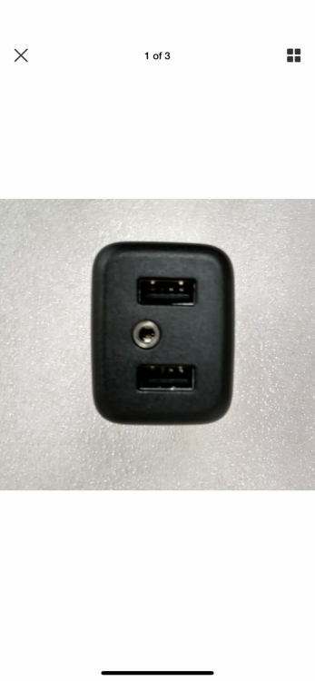

Im also trying to do this upgrade for my 2015 Silverado 1500. I found some parts online but im not sure if these are going to work with my truck. I just followed @Ben Bassinger list of parts he used earlier in the thread. Im reluctant to buy them I want to make sure they will work. Also I need a programmer either WAMS as that's what he used or @th3magpi3 can possibly help me out. As it being a 2015 I will be purchasing the newer radio module ( I would like the HD radio), HMI 2.5 Module and the updated USB ports. I attached photos of the parts that I found online. I really just want Apple Car Play.

Im also trying to do this upgrade for my 2015 Silverado 1500. I found some parts online but im not sure if these are going to work with my truck. I just followed [mention=45186]Ben Bassinger[/mention] list of parts he used earlier in the thread. Im reluctant to buy them I want to make sure they will work. Also I need a programmer either WAMS as that's what he used or [mention=192095]th3magpi3[/mention] can possibly help me out. As it being a 2015 I will be purchasing the newer radio module ( I would like the HD radio), HMI 2.5 Module and the updated USB ports. I attached photos of the parts that I found online. I really just want Apple Car Play.

I went ahead and ordered all 3 three items. New USB Module (P/N: 13509942), Used Radio Module (P/N: 23402909), and used 2.5 HMI module (P/N: 84028492) . What are some programing options that I can get with this besides the apple car play? I seen that some people have Video playback, back up camera always on, GM NAV, etc. Also do prices change for each custom option program?
