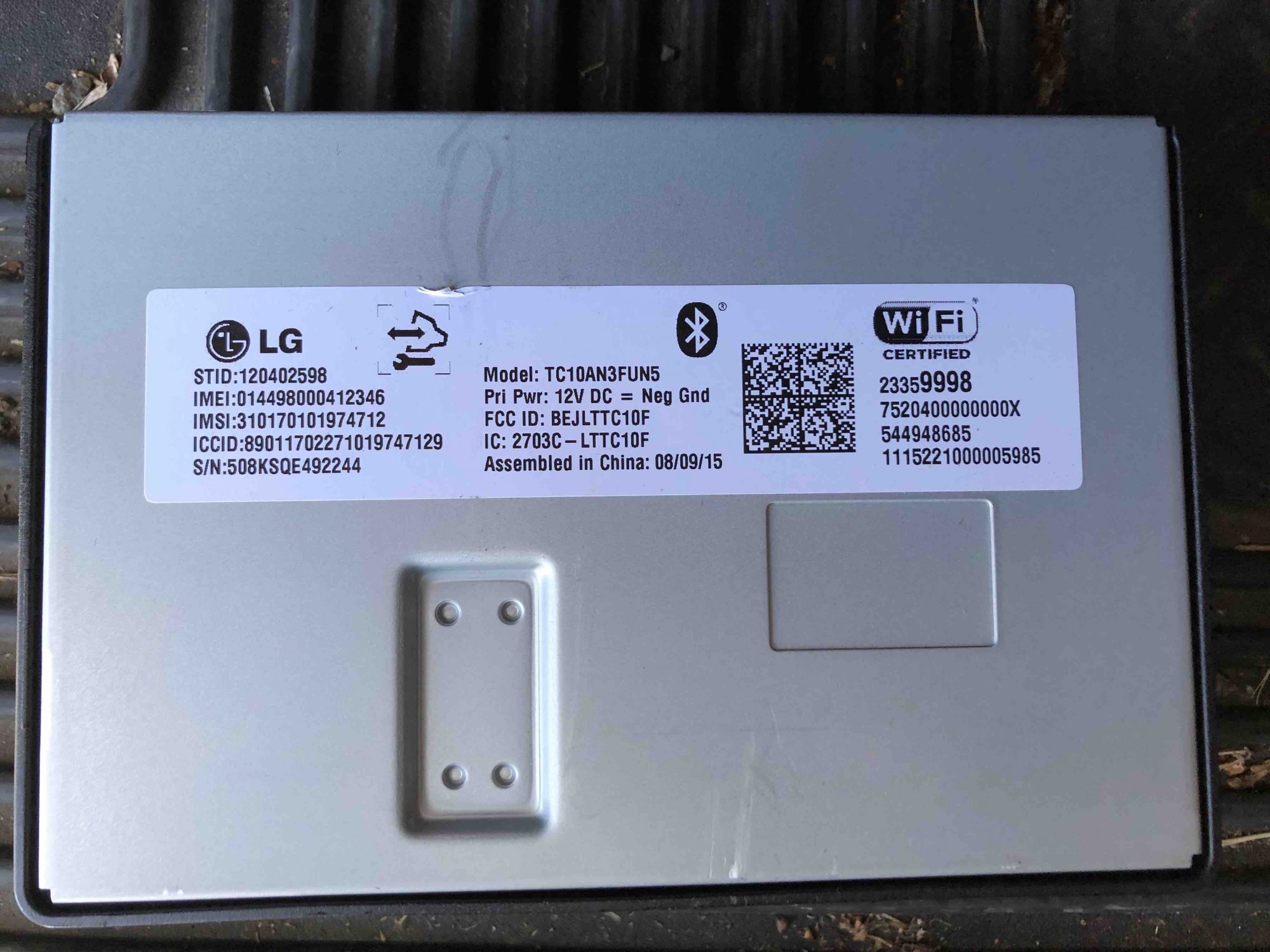

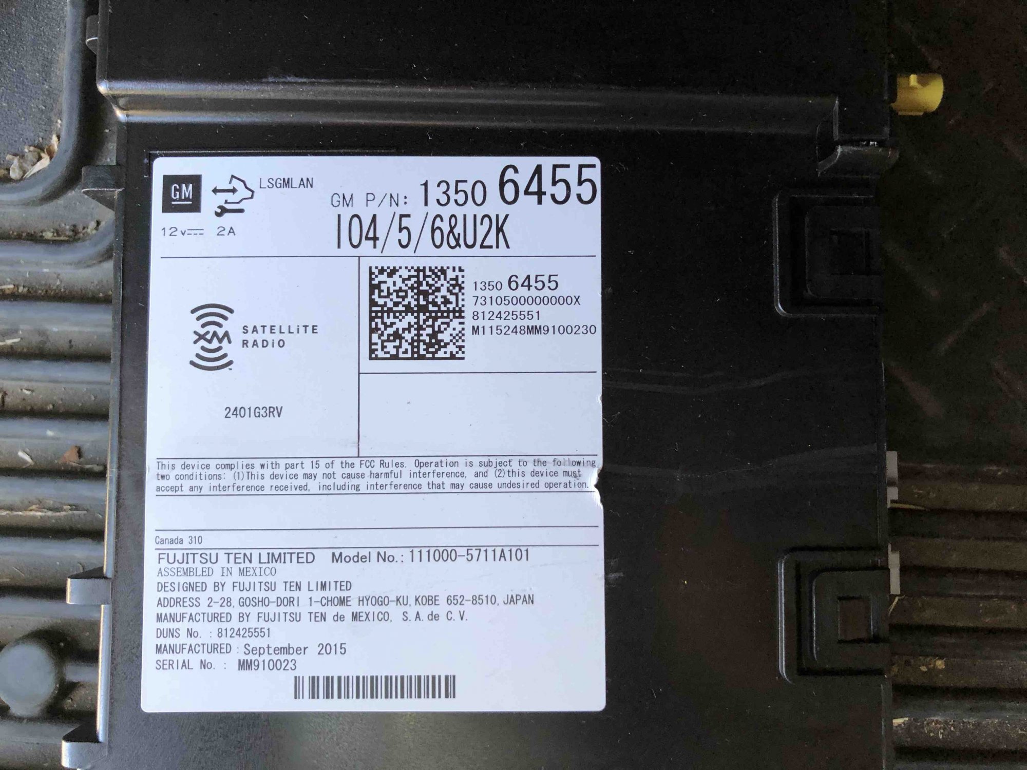

Hi all, I've been lurking and learning for a while here and am about ready to pull the trigger to get my '15 2500HD LTZ to have ACP. I did my due diligence by pulling apart the dash and glovebox to figure out exactly what I have. Could someone please help confirm the parts and actions I need to take before I spend money unnecessarily? @th3magpi3 If you're up and running to the point I can have you re-code an HMI 2.5 for my truck I'll gladly pay you for your services based on the amount of effort you've put in to this.
I discovered I have the following:
HMI 2.0
IO4/5/6&U2K:
radio module:
If I read everyone's notes correctly, I need the super-expensive version of the HMI 2.5 (if I want to keep all my factory functionality), the HMI 2.5 coded to my radio module and/or IO6 module, and the 13519224 USB module for the center console? (that's question #1)
Since I need the HMI 2.5 for IO6, the available sources are eBay (dokus) or White Automotive & Media Services (on vacation until today, 10/1/2018), or Digital Dash Solutions, or MVI? (question #2)
Assuming I get an HMI 2.5 coded to my VIN and put the correct USB module in the center console I should be good to go; 10-15 min of work, right? (final one, question #3)
