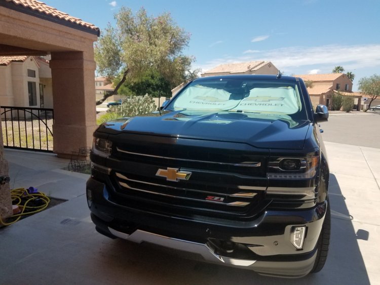

Yeah, but those LED headlights/taillights are legit, plus everything works just fine on Android Auto, especially Waze it's awesome! I'll be a weenie, any day awesomeness.
