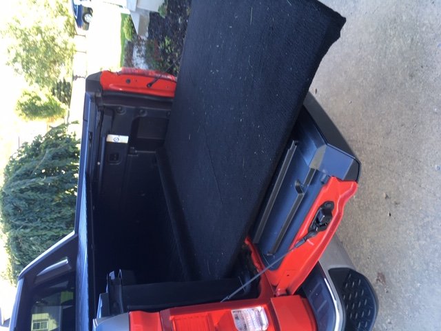

I can not answer that.  All I know there are three boxes in the bed that have new panels in them.  Since it's going to be 3 weeks for the rest of the parts to arrive, I've picked up my truck with a disassembled insert.  I have not compared the old panels to the new ones..

The V shaped seal that is designed to press against the tailgate when closed was damaged by me. On mine it doesn't touch in several areas causing water and dirt to enter the bed. In an attempt to modify it I tore the rubber.
I contacted a local dealership and they told me that rubber seal isn't available at all, he had to way to order one.
I looked up some parts places, but when I call to confirm the part nobody answers.
So at the moment I have it held together with gorilla tape.
Thirteen or 14 months ago the now deceased Service Manager at the dealership told me the original panels aren't reinforced and therefore sag.  They were supposed to be redesigning the panels with steel reinforcements so they wouldn't sag, they would be replaced under warranty.
He never mentioned anything about drain holes being enlarged or seals being replaced.  Either he did or didn't know about that.  It makes no difference as I said previously he passed away from cancer a little over a month ago.  With the selling and change of the dealership and change in Service Dept. people no one their knows about the problem.  My High Desert was the only one the former dealer sold.
Huskersfan,  I'm sure you know the v shaped seal is part of the third (rearmost) panel.  The whole panel has to be replaced.  It's ridiculous, but supposedly Chevrolet/GM is supposed to be replacing, under warranty, all three panels along with all seals and whatever else is included with TS8 18-135.
